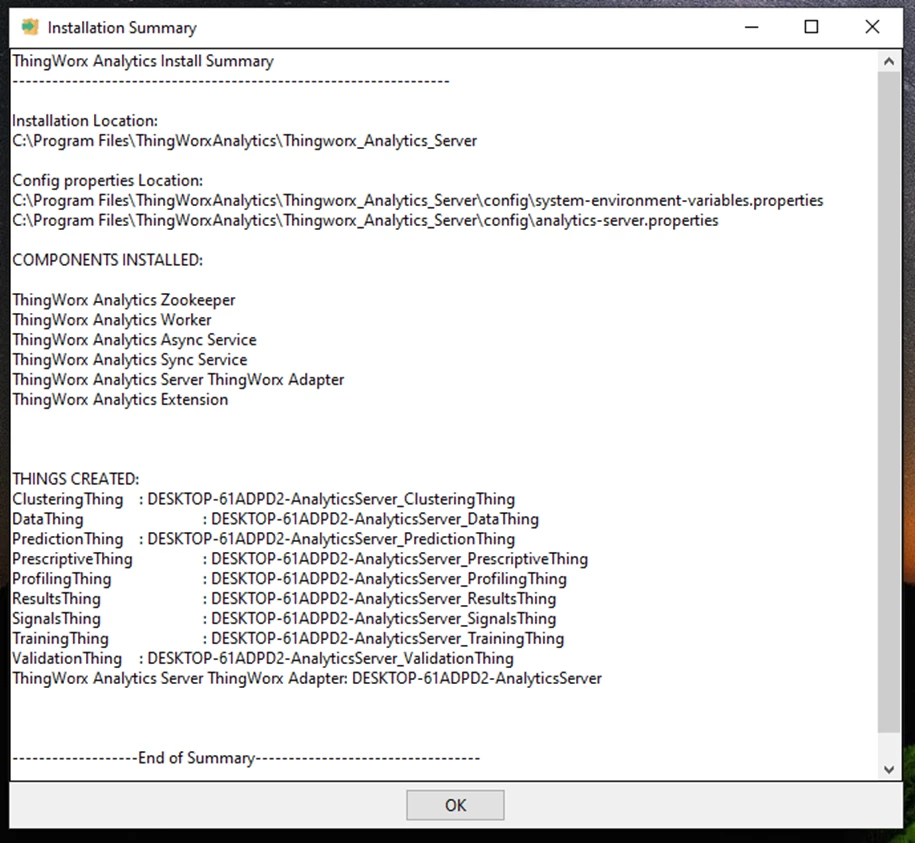

Hi All,
I just installed ThingWorx Analytics Server 9.3.1 together with Analytics Extension on ThingWorx Foundation 9.3.1. It is shown that the analytics server and extension have been successfully installed. But the the analytics extension icon never appears on the panel. Have tried quite some times, but the problem is still there. Please find the attached screenshots for more details. Thanks!

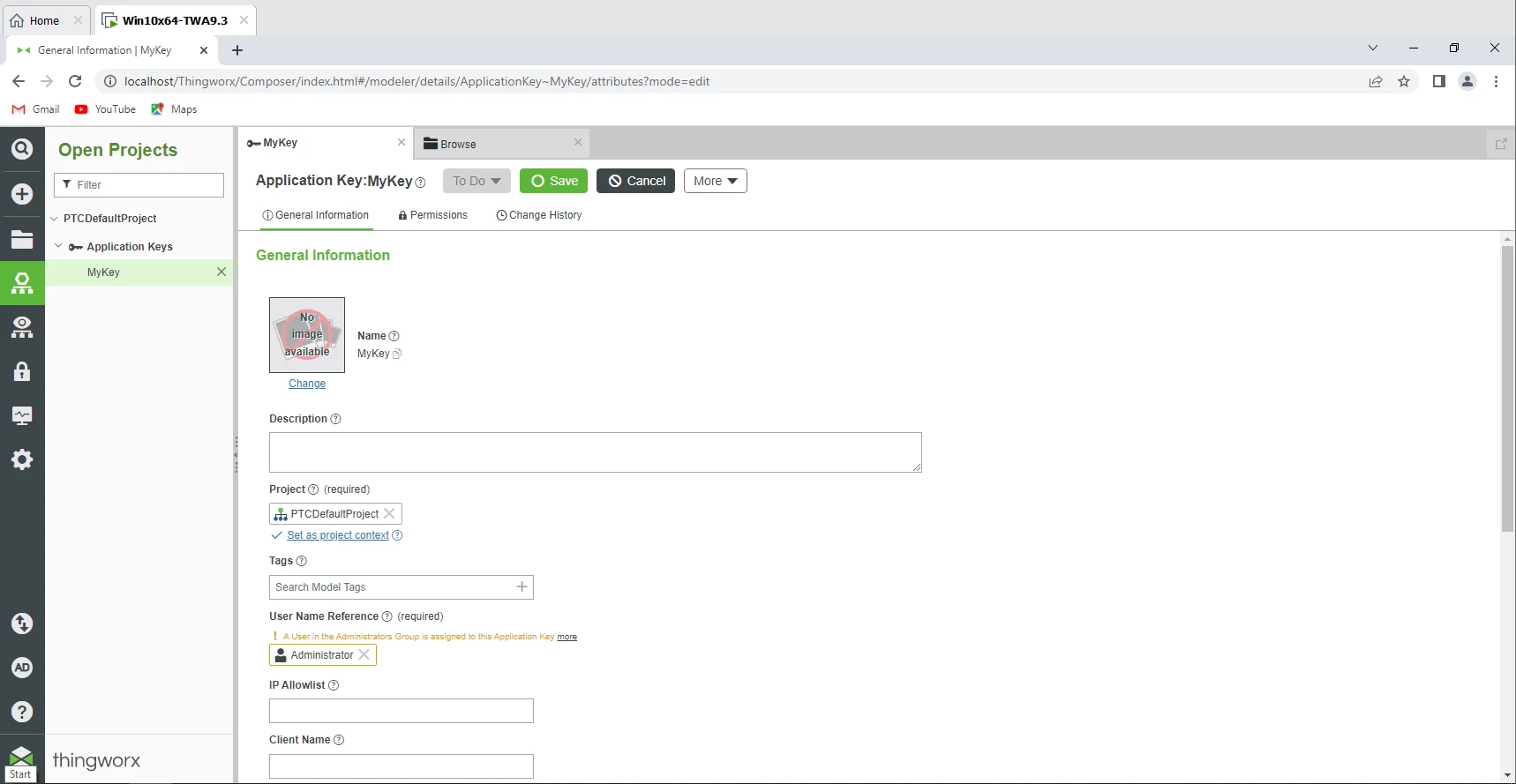

Hi All,
I've figured out the problem and fixed the issue. I moved the following text a little bit forward in the SAME section "PlatformSettingsConfig" in the setting file "platform-settings.json" and everything became good:
"ExtensionPackageImportPolicy":{
"importEnabled":   true,
"allowJarResources":   true,
"allowJavascriptResources":   true,
"allowCSSResources":   true,
"allowJSONResources":   true,
"allowWebAppResources":   true,
"allowEntities":   true,
"allowExtensibleEntities":   true
I believe that was due to bug(s) in ThingWorx Platform's settings parser.
Attached please find the self-explained pictures/files for your reference. Thanks all for the valuable suggestions!

Hello @JC_10255984 ,
Pls try applying this article on your end:
https://www.ptc.com/en/support/article/cs334206
Let me know if you need any further info.
Regards
Bhawna

Hello @JC_10255984,
You can try to manually import the Analytics Server extension and see if that fixes the issue.
Also, keep in mind to check the platform-settings.json to see if the extension import settings are set to "true".
Please also check this article for more details:
https://support.ptc.com/help/thingworx_hc/thingworx_analytics_8/index.html#page/analytics/extension-install/analytics-install-import.html#
Bogdan

Could you please try to import Analytics Server again and provide us with the Thingworx logs? (<ThingWorxStorage>/logs from the ThingWorx machine)
