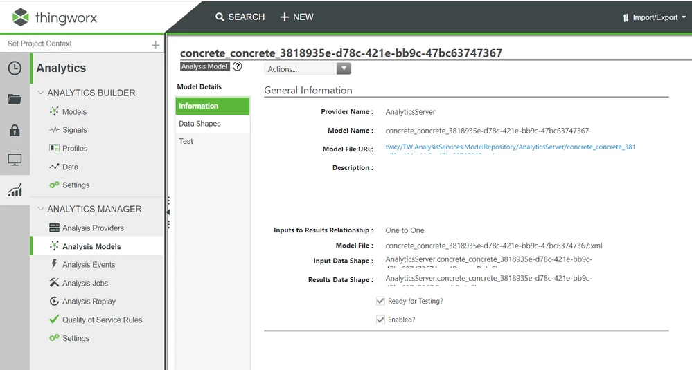

ThingWorx Analytics getting prediction model
How can I generate a pmml file from thingworx.
Related to post
tsaifee-2Answer
Oct 11, 2018 11:28 AM UTC
You can download a PMML representation of a Thingworx Analytics prediction model as follows:
- Publish your model from Analytics Builder
- In Analytics Manager, select the Analysis Model and click View
- Now click the link next to Model File URL. This will cause the PMML file to download to your browser.
See also the screenshot below.

tsaifee-214-AlexandriteAnswer
