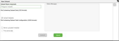

Hello, I'm trying to follow the tutorial "Build a Predictive Analytics Model", I've checked that I do have an AnalyticServer configured and then while trying to upload the data in the Builder section, I do not have any choice to import csv file :

The File Upload extension has not been successfully imported into your ThingWorx Foundation Server. It should have been imported when you imported the ThingWorx-Analytics-<n-n>-Extensions.zip

Thanks for your answer Rick, but obviously the import button is not visible in Chrome but is available while using Internet Explorer.
