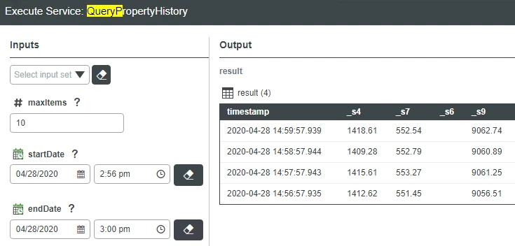

Thingworx used Value Stream to log Time Series Data, we can run service of QueryProperyHistory to get historic data:

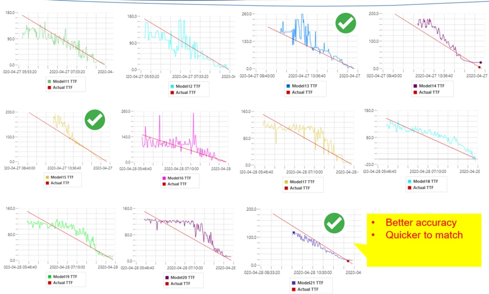

Below charts show the comparison between Time Series Data models predicted TTFs and actual TTFs.
We can see that, compare to Non Time Series models, the prediction is much more accurate, and is faster to match the actual TTF curve.

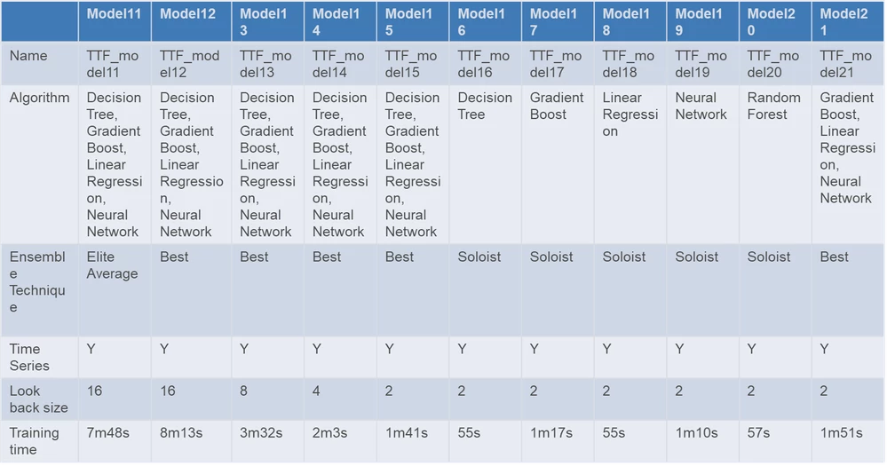

Below table lists out the settings of all models:
