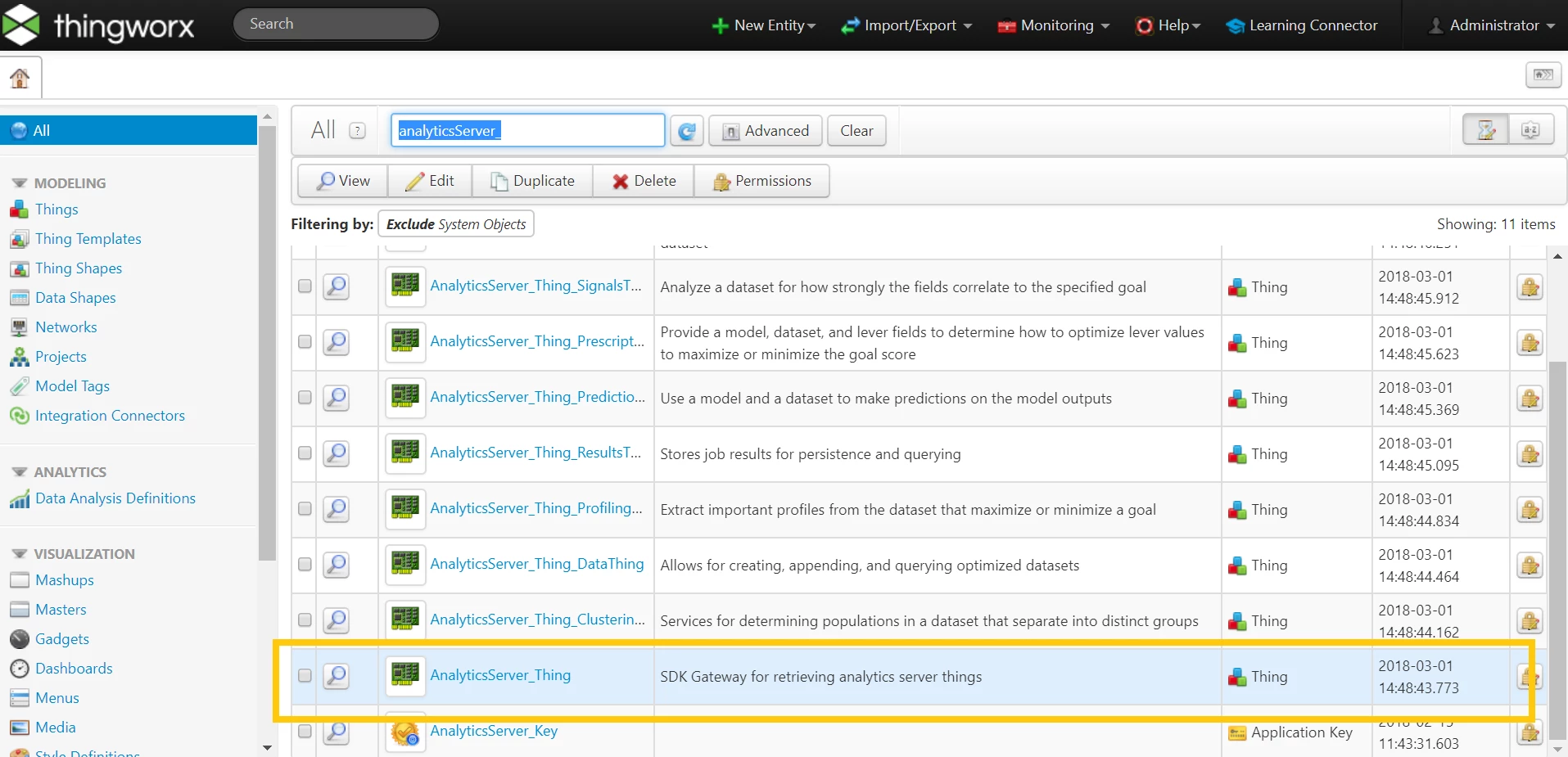

Hi all,
I started evaluating Thingworx and already added a mqtt thing and a mashup to my hosted trail version. Now I wanted to test the "Build a Predictive Analytics Model" guide, but I can not connect to the analytics server, when I try to select the analyticsServer_Thing in the analytics Gateway field there are no search results, I can also not find any "gateway" thing in my version. How can I solve this problem?

Can you confirm if you have installed an ThingWorx Analytics Server ?
If yes, what version is it, and what version of ThingWorx platform are you using ?
Do you see an AnalyticsServer_Thing in Composer ?
if yes, go in properties , what is the value for isConnected ?

Sorry for my late reply. I don't know if the analytics version is really installed, but the thingworx developer page says "The hosted trial includes Foundation, Utilities and Analytics so you can explore the platform capabilities for 30 days using our Guides. " The version of Thingworx is 8.2. No I can't find a AnalyticsServer_Thing in the composer.

Mar 6, 2018 3:10 PM UTC
Kos,
Sorry for the issues that you are experiencing.  There should definitely be a Thing called "AnalyticsServer_Thing" (see attached screenshot).  If you do not see this, the easiest thing to do is to have you export your work and we will provision you a new server.  Please reach out to the Developer Portal team (TWX-DevZoneHelp@ptc.com) and we can coordinate directly.
