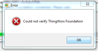

ThingWorx Analytics Server failed to validate
I am an error to verify the ThingWorx Foundation connection.
I am running ThingWorx Analytics server on a windows 7 , 16GB and 8 cores, diferente than ThingWorx Foundation
I have installed the Docker Toolbox and make sure that I have a computer that has a HAV capable processor and if this feature (HAV setting) is enabled on the processor (from the BIOS).
I can ping my ThingWorx Core Foundation Server IP from my windows 7, but my browser can not access to my ThingWorx Core server with an 8080 port.
Kepware connection uses port 80. but when i Try to install using port 80 it fails too.  Launching the server:8080/Thingworx fails but when i use the hostIP:80/Thingworx redirects to the composer.
any ideas?

Hi Valeria,
The issue is resolved, as you were using the expired app key. The installer was able to verify the ThingWorx Foundation, once the updated app key was used.
