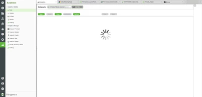

my thingworx analytics tab can't load dataset

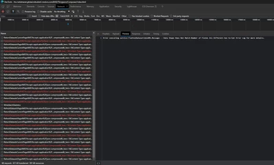

Have you look into the script error log as the message recommends? What does your data look like?
It appears the metadata does not match the data.

this is error message
"Error executing service FlattenDatasetJobsAMS.Message: : Data Shape Does Not Match-Number of Fields Are Different-See Script Error Log for more details."
is possible to I reset or delete all dataset and create again

You can do that or just create a new one with a new name. Your other screenshot does not show any existing dataset, but it also looks like the screen was still loading.
