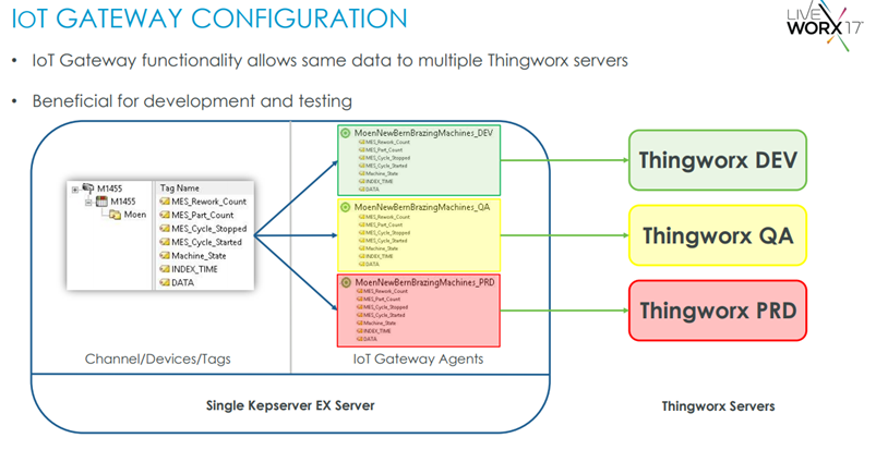

we are in process of connecting IoT gateway to multiple Thingworx environments, namely PRODUCTION and TEST. Problem is that IoT Gateway Agent does not accept multiple endpoints nor identifier, so we are forced to use multiple Agents with different names. But when we move projects from TEST to PROD, we also need to disconnect all the connections bound to specific name.
One of the solutions is described bellow in image from LiveWorx 2017 presentation (pdf in attachment) by Yale Evans​.
I was just wondering, is there more elegant way do this? Replacing name of the Thing in XML when moving to PROD is problematic.
Maybe support of multiple endpoints in kepware or support of identifiers, so that you only have to flip them in Remote Thing?
Thanks and regards JG.

If you review the next few pages in that presentation I also described creating another intermediary entity that binds its properties to the kepserver entities. Then in all your development work, you only utilize the data in the intermediary entity.
The intermediary entity would have the same name in all environments, but its properties would be bound to the environment-specific kepserver entity.
You would export this intermediary entity once from dev, do a mass replace of "_DEV" with "_QA" to update the binding definitions and import to QA (and the same for PRD). Then, when you are changing all the other entities that ONLY REFERENCE the intermediary entity, you will NOT have to replace anything in the XML exports. (You would not be including the intermediary entity, just the other entities that reference it).
Also you can look into using the federation capabilities of Thingworx - you can connect Kepserver to only one Thingworx server, and federate the data from that Thingworx server to other Thingworx servers. This may or may not work depending on the functions you are performing in Thingworx.
Let me know if this helps or if you have any other questions.

Thank you, I think I get the point here.
But this all could be easily solved if:
  • IoT gateway Agent could have different name for Agent and for RemoteThing, also called Identifier in ThingWorx.
  • IoT gateway Agent supported multiple endpoints.
Do you know if any of this is possible? If not, maybe it is good candidate for feature request?
