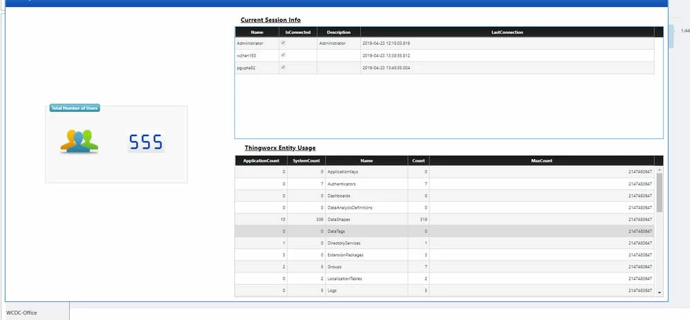

PSM 6 is enabled with Thingworx monitoring. However we do not have that in production yet. In the mean time I created this Mashup.
Preeti
