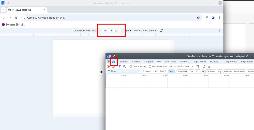

Open DevTools, click on the "screens" button and input required resolution there -- you'll be able to test with 1920x1200:
/ Constantine

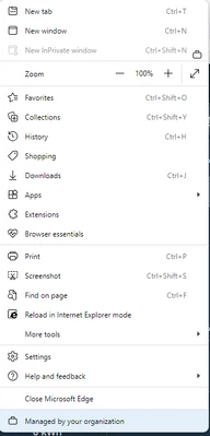

We have tested the application at 1920 * 1080 with pc settings then we didn't get any scrolls but we got horizontal scroll and vertical scroll for the screen when using browser with inspect as above to view same resolution.
our browser setup is as per below screenshots.:
There are two different zoom percentage options at inspect in screenshot 1 and the other in browser setting in screenshot 2. Kindly let us know what is difference between both and why scrolls when using inspect option.

You have "1872x1080" on your screenshot. That's wrong. Change it to 1920x1200, then adjust the zoom until the scroll bars disappear. Then test.
