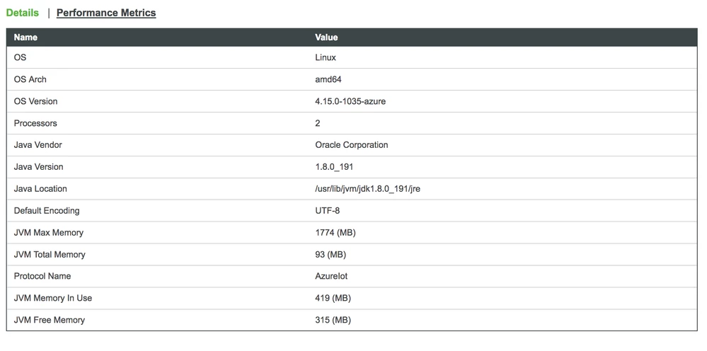

I was not able to identify the process using top, but I have the resource usage from thingworx:
Dec 31, 2018 3:43 PM UTC
The issue is not with ThingWorx rather your OS not able to allocate memory so output from Thingworx  resource usage page is not helpful. Can you provide output from top as explained earlier instead?
Logical and most likely solution to update memory in your VM as 7GB doesn't seams to be enough to run whatever processes you have running.
