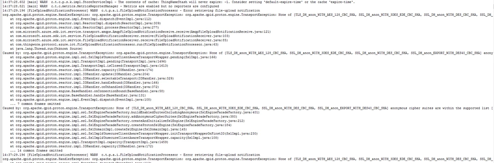

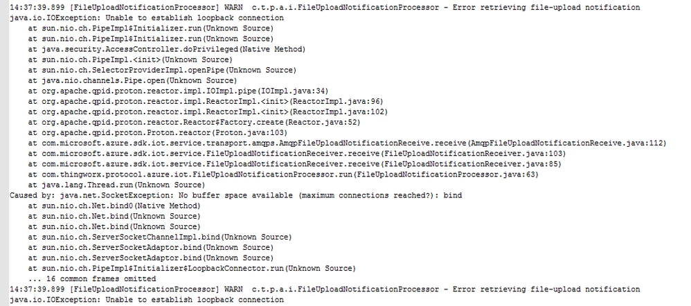

I've been working on getting this Azure IoT Hub Connector started for a while now, and it finally seemed like it was going to work however, when I enter the 'azure-iot.bat' command there's no output in my command prompt but the connection server appears in my ThingWorx platform.  While the command prompt is open, the cxserver file grows rapidly.  Then, if the command prompt is closed the connection server disappears from ThingWorx.
Is this normal behavior for the connector? Everything I've read says it should start to process data after entering the 'azure-iot.bat' command but I get no output in command prompt.  The images contain the different errors I am getting in my cxserver file.

To answer your questions, when you execute the azure-iot.bat command, you are in fact starting the connector.  This window will need to remain open otherwise the connector shuts down.  This is by design.  This explains why you only see the connector in ThingWorx when the command prompt window is open.
In regard to the errors from the cxserver.log, are you still seeing the "entity does not exist error" or are you now seeing different errors?  If the former, please make sure you have followed the instructions from the ThingWorx Help Center for creating the thing.  The connector will not create the thing automatically--you will need to do so.

The behavior you are seeing is not normal.
We would need the following to troubleshoot:
  • The configuration in Azure
  • The azure-iot.conf file
  • Also, when running azure-iot.bat if you could output to a file, that would be helpful:  azure-iot.bat > azure-iot.log
