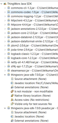

Hello @Velkumar,
The JSDK libraries haven been reorganized in 7.0.0.
As a rule of thumb, you can reference all the JARs from <JSDK>\lib (except *-javadoc.jar) in your eclipse project.
