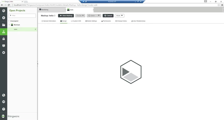

when i use chrome , chose Design table ,it show none, and what is error?  it make me very uncomfortable,

Hello @RH_9721753
As per the screenshot shared by you it is still loading. So can you please check logs under monitoring section for any possible errors?

Hi @RH_9721753.
This issue can occur if you have installed an incompatible extension.  What extensions have you installed?  The fix is to remove the extension in question.

I think you are a company with good service, and your reply on this issue is really timely. I have found the reason for my problem, which is that I installed it on the Server system, and it runs very well on Win10.
