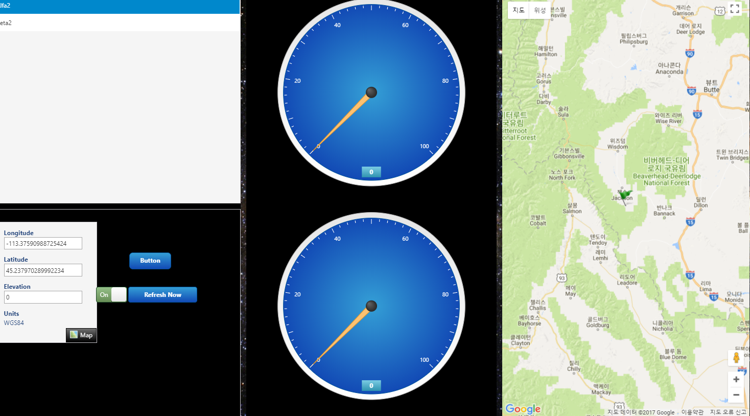

In video lecture, we use yahoo to show the weather according to the location through gauage
It was a video lecture using yahoo api but it did not work well and I used wunderground
make thing, thing template, mash up..
The cause is that the services of thing template seems to be a problem
thing template - services - script

and base type : infotable
error message is "Unable To Convert From org.mozilla.javascript.UniqueTag to INFOTABLE"
what problem? Temperature and humidity of the gauge do not react
help me please

Hi Jeong, can you share the service definition for this script? What are you attempting to return as result from that service? How is it bound to those widgets? Additionally, would it be possible to share which video link you are following?
jeonggwan1-VisitorAuthor
November 29, 2017
My intention is to set the position on the left tab, temperature and humidity will be displayed on the gauge depending on the position...
and video url : PTC Learning Connector
'Creating a Mashup'
in this video use yahoo weather informaion, but yahoo not working
so i used wounderground intead of yahoo
