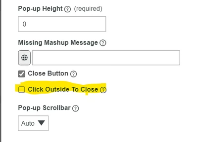

Hi @VN_10171538
In popup you can use 'Click Outside To Close' option to achieve it
/VR
