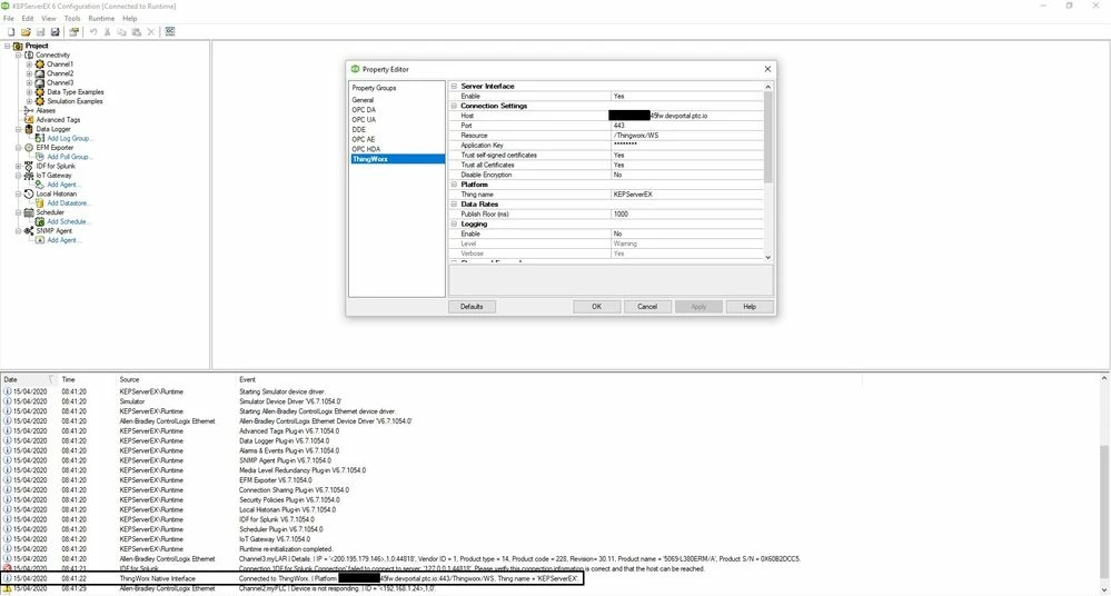

I am making the configuration to communicate KEPServerEX with the Thingworx platform on my computer. I'm using:
Thingworx Free Hosted Server 30 days
KEPServerEx 6.0
KEPServerEx 6.7
Windows 10 Pro

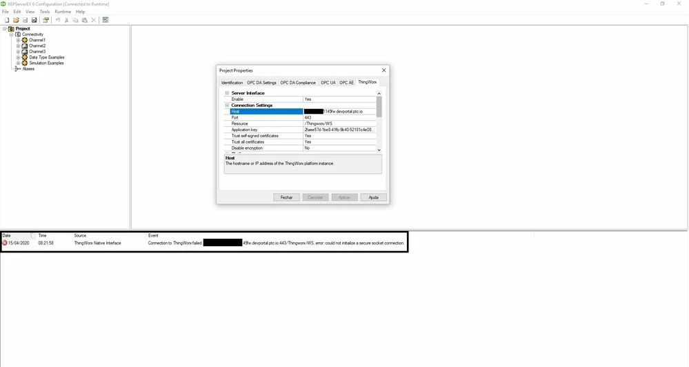

First I tried to perform the communication through KEPServerEX version 6.0 and it didn't work (image below).
After I tried using version 6.7 using the same settings and it worked (image below).
Is anyone able to assist me in this problem? Because I need to install version 6.0 on my client.

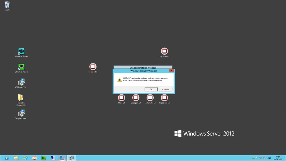

When I try to install version 6.7, it is requested to update the 2013 CRT and as this is in a windows server 2012 I am afraid that when updating this service it may negatively impact some existing communication. Here is the image below when I tried to install version 6.7 on my client:

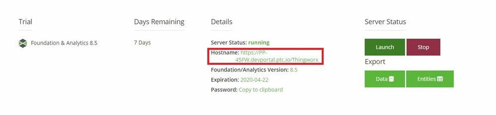

Try connection with IP address: https://www.ptc.com/en/support/article/CS308496
Hope it helps,

Hi @raluca_edu
Thanks for your answer.
I am a beginner with Thingworx.
How do I to verify what is the IP Address?
The only address I know is it:
