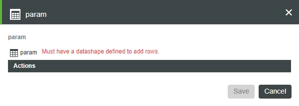

Currently I´m facing some issues writing a custom Java Extension that has a service with a parameter of type InfoTable.
The Service parameter is annotated like this:
@ThingworxServiceParameter(name = "param", description = "", baseType = "INFOTABLE", aspects = {"isEntityDataShape:true", "dataShape:TestDataShape" }) InfoTable param
Here the baseType is set to "InfoTable" and in the aspects array a DataShape is pointed that exists on the ThingWorx platform.
When I try to execute the Service interactively and want to enter the parameter values I get the following message:
I am using ThingWorx 8.4.5-b102 and I am pretty sure this has been working with ThingWorx 7.4.
Has anybody any adivce or can reproduce this issue?

Hi @sburton-3.
It appears we have a fix coming for this issue in the 9.0 release.  The target date for 9.0 is June (but is subject to change).
However, a workaround is to use the AddStreamEntries service in a custom service.  This way you can define your infotable with the data shape needed to pass to the service.

Can you try to remove the "isEntityDataShape:true" aspect ?

I have the same issue using an INFOTABLE as a configuration item on a custom ThingTemplate from an extension I have created.
Since I have also seen this error come up with some of the out of the box services on other Thingworx objects, I believe that this a bug in the Thingworx Composer on Thingworx 8.4.x (I do not see this on version 8.2 in the old Composer) where any popup requiring a DataShape definition does not seem to correctly retrieve that definition, even though a DataShape is defined.

I was able to work around the issue by exposing the INFOTABLE as a Property on the Thing rather than as a Configuration item.
In other words this doesn't work as expected ...
@ThingworxFieldDefinition(name = "MessageHeaderProperties", description = "", baseType = "INFOTABLE", ordinal = 0, aspects = { "isEntityDataShape:true", "dataShape:CAT.ServiceBus.CustomHeaders.DS" })
Yet this does ...
@ThingworxPropertyDefinition(name = "MessageHeaderProperties", description = "", category = "Configuration", baseType = "INFOTABLE", isLocalOnly = false, aspects = {
"isPersistent:true", "dataChangeType:OFF", "isEntityDataShape:true",
"dataShape:CAT.ServiceBus.CustomHeaders.DS" }),
In terms of the out of the box services - we were seeing the same issue with AddStreamEntries() on a Stream that was using InfluxDB as a persistence provider. However, when we downgraded Influx to a slightly older version at the request of PTC tech support, this issue appears to have resolved itself.
