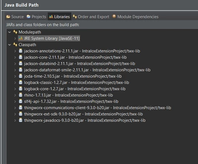

I have also run into this issue. I have tried several combinations of Eclipse, JDK and TWX SDKs using ANT with no resolution, including the recommended combination.

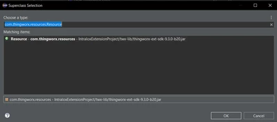

What happens when you click "Browse" right of the Superclass field?
Looks like it can't find the com.thingworx.resources.Resource in its classpath. Make sure the project has thingworx-ext-sdk-9.4.0-b49.jar (or your version) in the build path. (Project>build path>configure>java  build path> libraries>Classpath) Make also sure this is the only jar in your build path containing com.thingworx.resources.Resource so you don't have a collision.

Sorry for the delay. When I click browse there is only one com.thingworx.resources.Resouce. I have tried with various versions of the thingworx sdk with no luck.
these are the current jars

@mariaSutton , I think you are very off track with your effort.
There are several steps which need  to be followed to setup the environment.
When you have followed the steps there are items which are inserted into the Eclipse menus.
When you run the build process which is in one of the menus it will build a zip file. It is important to use this process because it is not simplify a JAR file but a collection of files which describe the extension.
The direction is to the build using Gradle or Ant.
Let me know where you are and I will try to assist.
