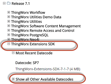

Update on this topic : Jira PSPT-4202 has been filed to correct this issue , in the meantime please download the desired ThingWorx Extension SDK from PTC Software Download page

Hi Quang, have you tried getting it from PTC Software Download page? It's available directly under the ThingWorx Platform folder
I'm checking for the marketplace in the meantime.
