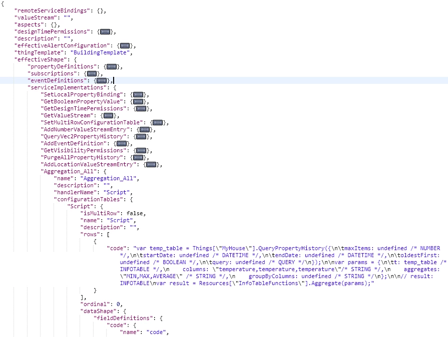

I am exploring the rest apis and java sdk apis for ThingWorx 8.5. I want to fetch the metadata of a Thing. I can do the same via REST api - <server/Thingworx/Things/{thing_name}. It returns json that contains all the services listed under key serviceMappings with their implementation under key serviceImplementations -
But the parallel java api on ConnectedThingClient getThing(<name>).getMetadata() returns _serviceDefinitionCollection and _serviceProcessors as null.
Am I missing anything here? How can I fetch the metadata for the Things' services ?

I have a Thing named MyHouse on the platform. I am trying to connect to the platform using following snippet -
VirtualThing myHouse = new VirtualThing("MyHouse", "Sample Description", client);
client.bindThing(myHouse);
client.start();
InfoTable metadata = myHouse.invokeService("GetMetadata", new ValueCollection());
 This returns an empty InfoTable instance.
When I used invokeService() api, I get the correct result InfoTable -
InfoTable metadata = client.invokeService(RelationshipTypes.ThingworxEntityTypes.Things, "MyHouse", "GetMetadata", new ValueCollection(), 30000);
Is this a correct way to connect to the platform?
