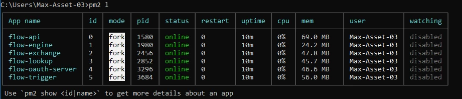

Velkumar19-TanzaniteAuthor
April 9, 2019
Hi @weli
Its not working and I found all services running properly in instance

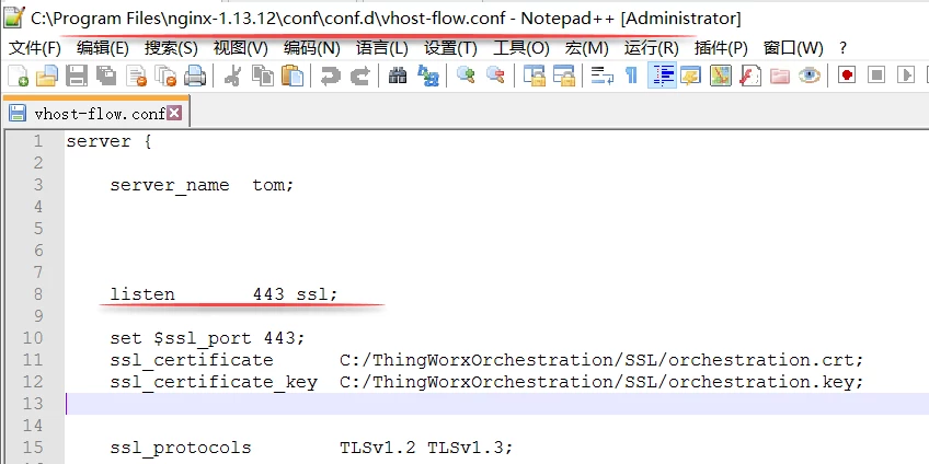

April 9, 2019
@Velkumar
Please check the following file.
Mean while, please notice  my server name  is “tom”, so I have to config my host file as:
192.168.58.196 tom
