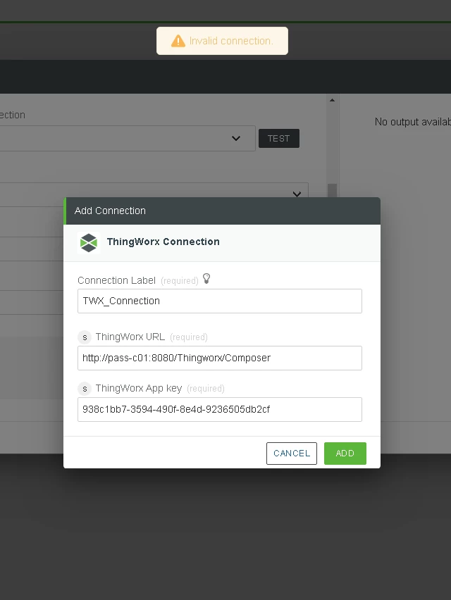

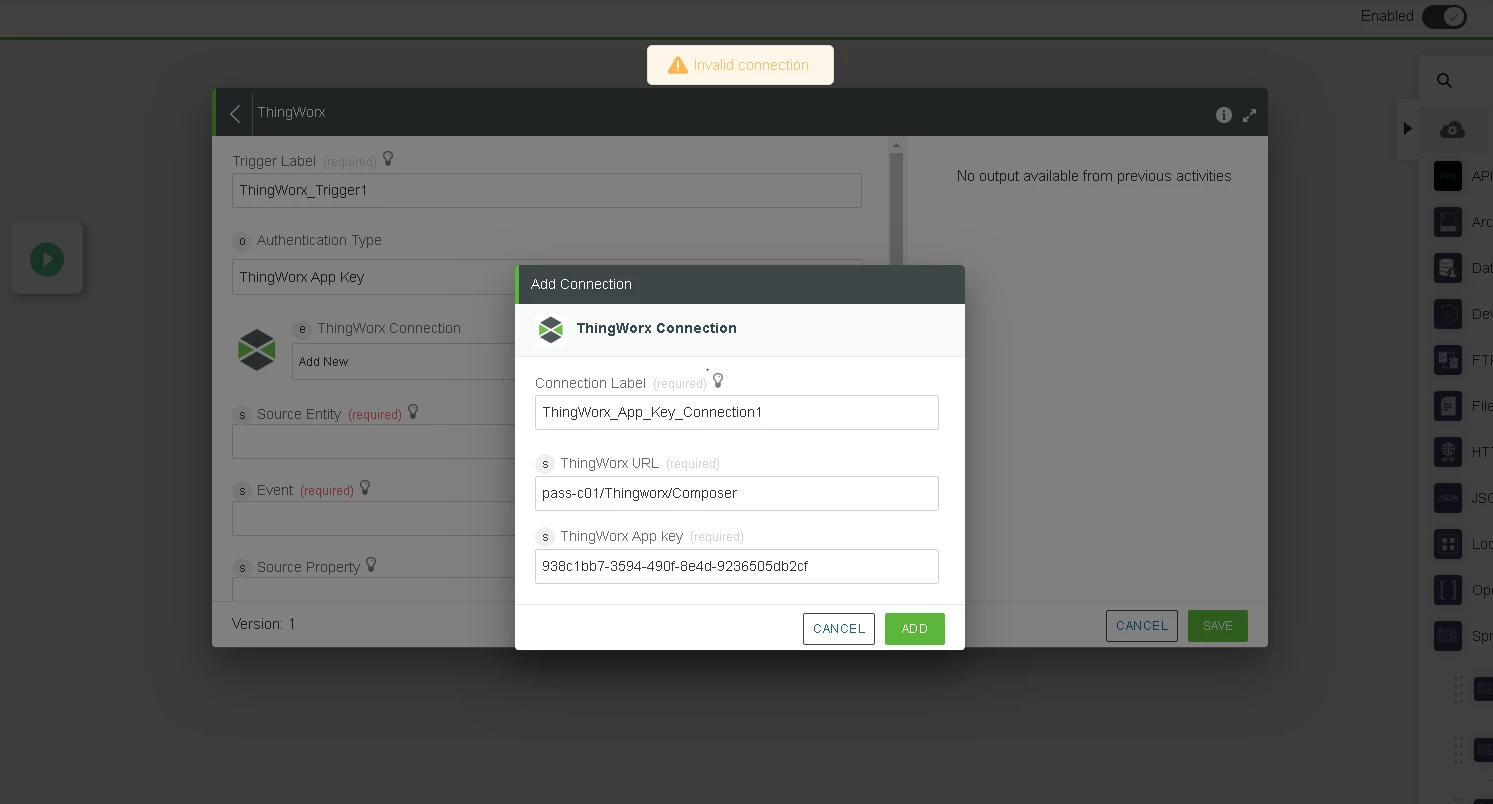

I am getting the following error (Invalid Connection) when I attempt to create a connection to Thingworx from Flow.
Also getting Error 404 when attempting to add a Workflow from within a Thing.
Have logged a case with support - but is it because I am using a trial?
UPDATE - I created a new connection. It didn't like the connection being created using an Application Key. However when I used basic authenticiation - it worked!

For connection to Thingworx please use the following format for ThingworxURL:
http://host:port/Thingworx

Thanks for the reply. It still did not work the following URL.
http://pass-c01:8080/Thingworx/Composer/
However if I modify it to the following -
http://pass-c01:8080/Thingworx/Composer/#

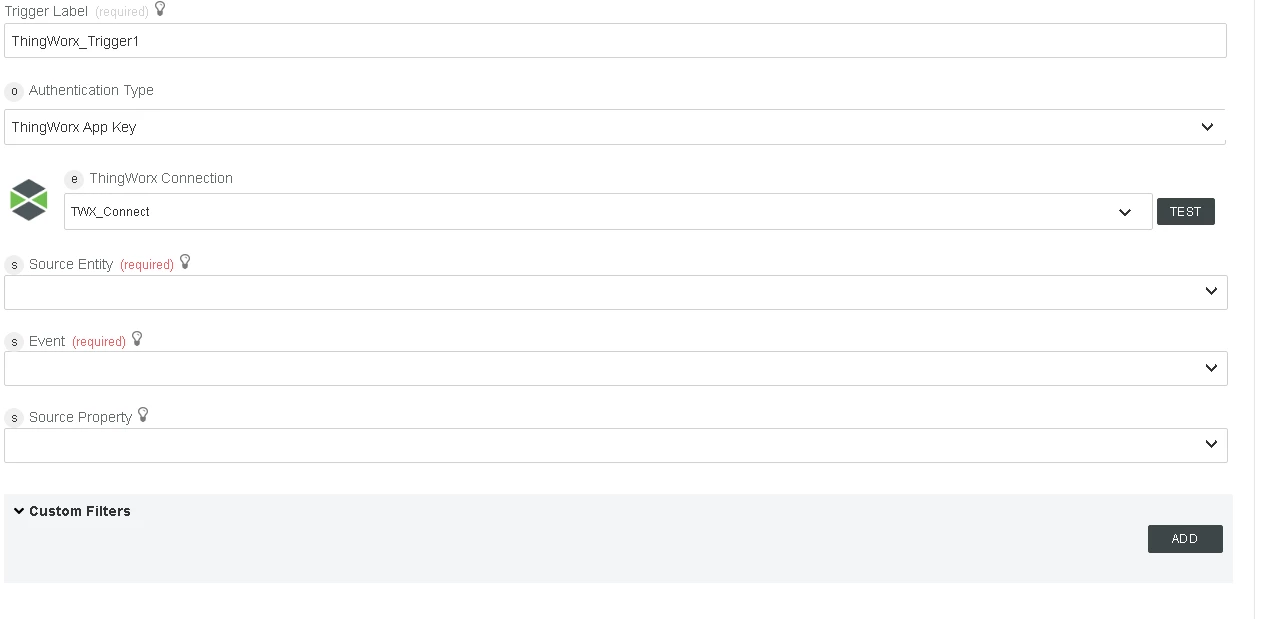

It worked and it created the connection. However I am now unable to browse any Things from the Thingworx trigger.

Hi @OGCORF1974.
Remove "Composer" from the url:  http://host:port/Thingworx

Thanks for your help - I am slowly getting there. I tried https://PASS-C01/Thingworx and this worked!
However when I try to browse my (Thingworx) source entities I get 'no results'.
Looking at the help should I get a list of Things I can then use to trigger the workflow - or  is there something else I need to do?
This is for a demo I will take a look at the app key issue another time.
