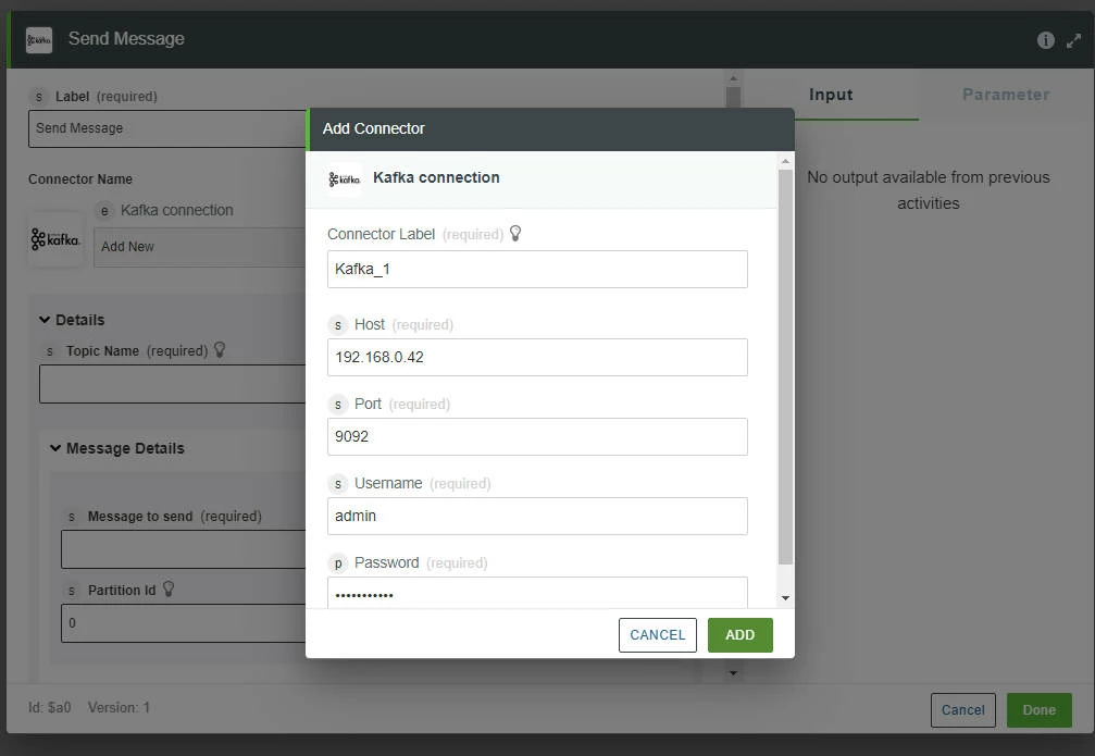

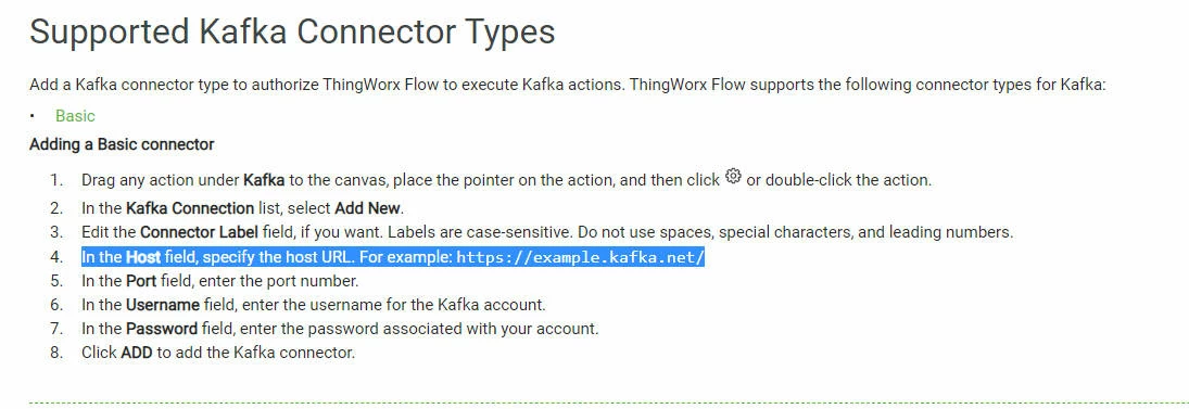

Wondering anyone had it work ever ? The online help gives an example for the host field with http url , so confusing. I thought it should be bootstrap server.

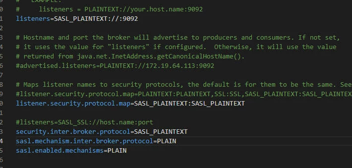

after setting up SASL_PLAINTEXT on the Kafka broker, the flow could connect with its kafka send message.
Just wondering why this has not been documented well in the online help document.
