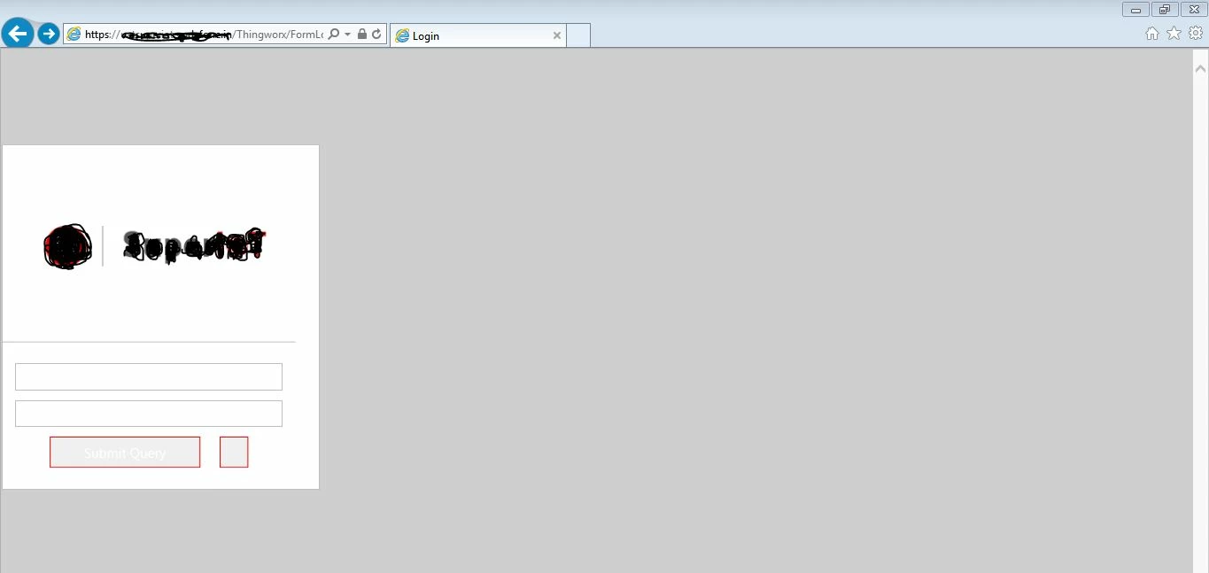

Form Login page has login prompt in the center of the web page when loads on Chrome browser.

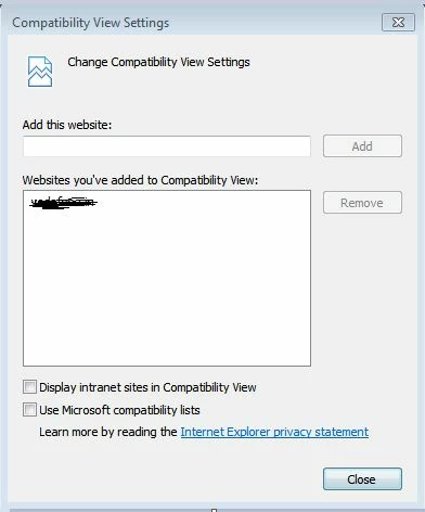

But when I try to load Form-Login page using IE Browser with Compatibility settings,login prompt get shifted to left side of the web page.And it work fine once we remove the Compatibility settings on certain machines but on few other machines,this doesn't work and get shifted to left side of the window with distorted CSS.
Please find attached snapshots of IE compatibility settings and Form-Login after doing compatibility settings change in IE.

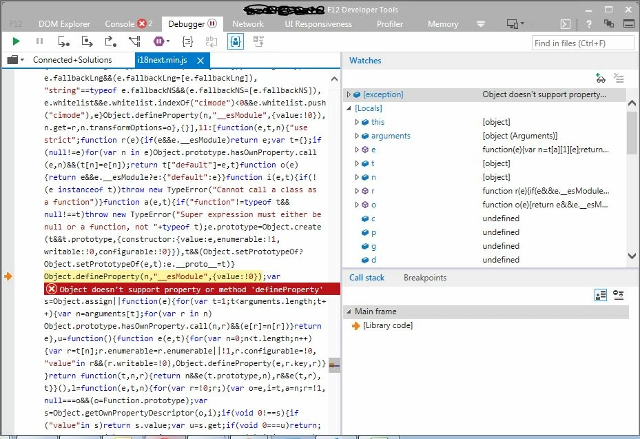

If you can, look at one of the problematic IE systems and use the F12 tools to look at the debug console and see if some error(s) is displayed on the problem browser which is not on a browser that works correctly.

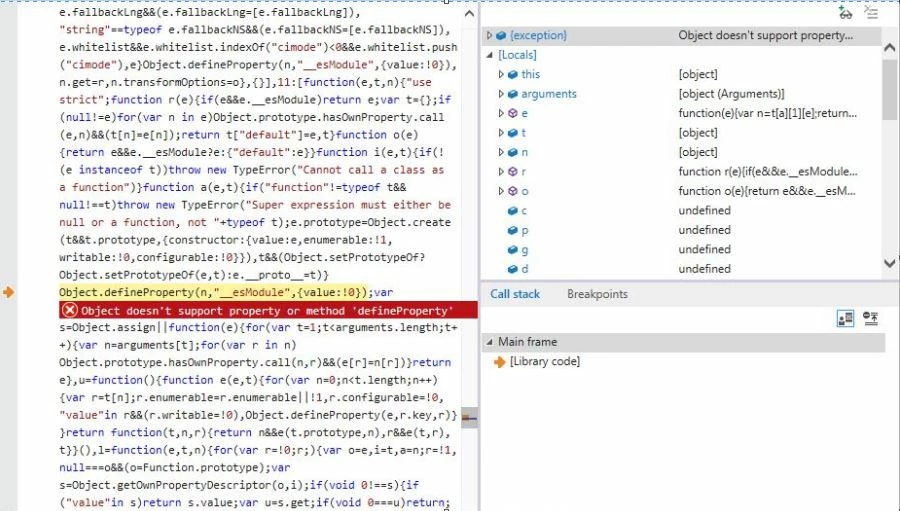

Also,used F12 option to see bugs,if any. Screenshot of the same is attached.
I guess some HTML/CSS tag is missing and have to be there in Thingworx CSS files.
