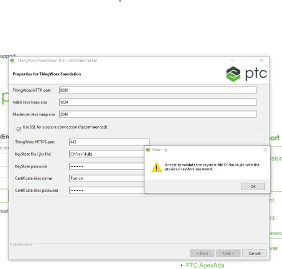

I am trying to install the 120 day ThingWorx Foundation 8.3 trial. I created a Keystore.jsk file using the following instructions: https://tomcat.apache.org/tomcat-8.5-doc/ssl-howto.html#Prepare_the_Certificate_Keystore
During the installation when I try to move past the "Properties for ThingWorx Foundation" page, I receive an error that reads: Unable to validate the keystore file with the provided keystore password. (See attached picture).
I have tried multiple times and have confirmed that I am using the correct password but am still getting this error.

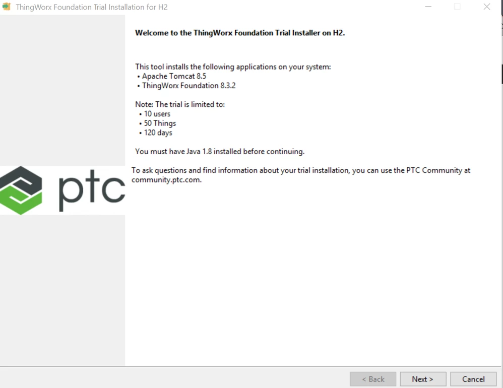

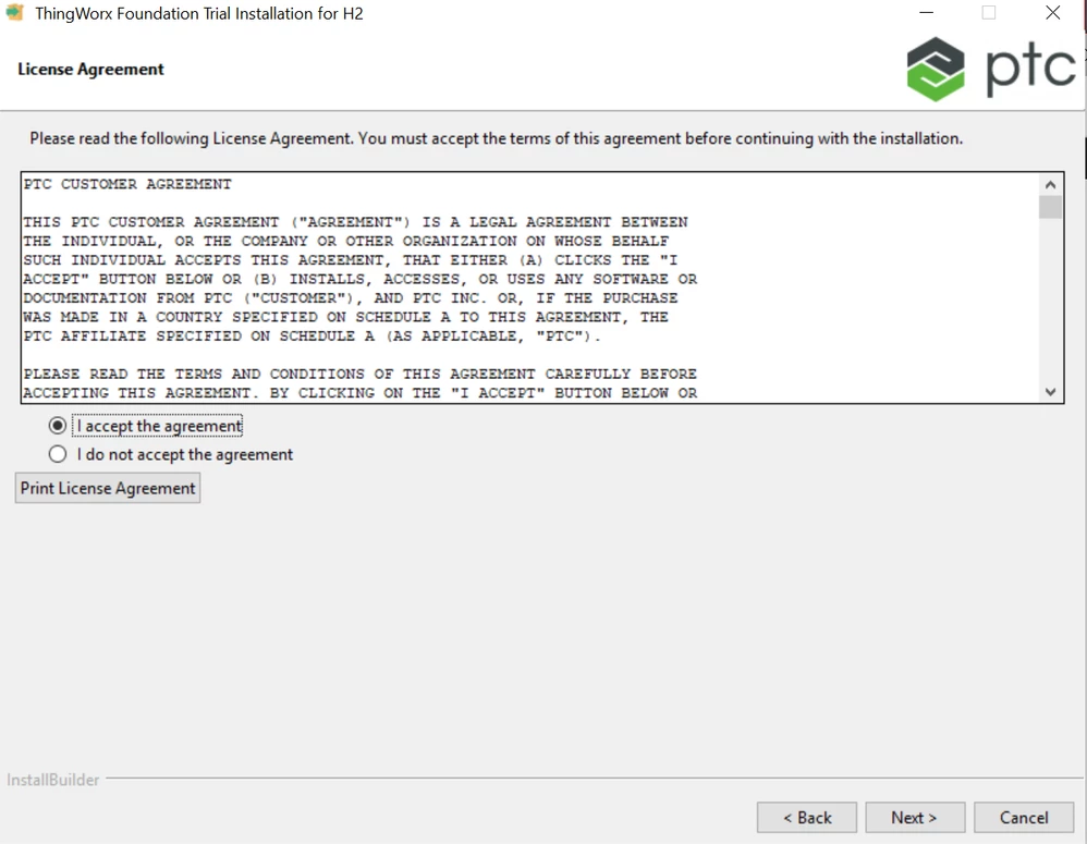

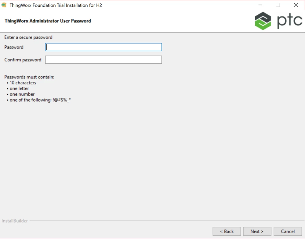

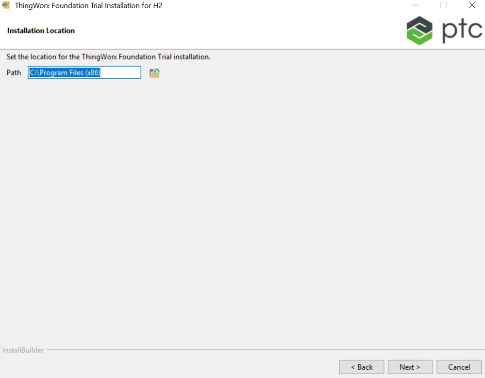

I noticed that in the installation guide you provided the installation pages do not match mine. I have attached the first few pages in this response for your reference. As you can see after the 3rd page it asks for an administrator user password (I was using my PTC account password). After this it asks for the keystore file as can be seen in the image attached in my original post (I created one using the tomcat instructions in my original post). I have also tried re downloading the installation package many times and never received a json, keystore, or license file. Am I using the wrong installation or is it something else?

From the screenshots you provided, I can see that the 8.3 version defaults to SSL.  This implies that you have your own SSL certificate and it has to be in the format needed for Tomcat.  To get around the SSL requirement, you can deselect SSL and it should allow you to proceed with the installation.
