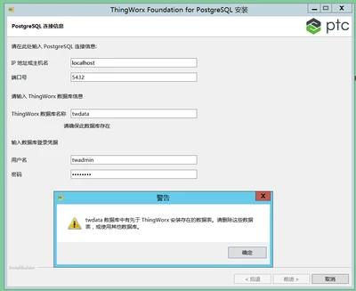

ThingWorx Foundation 8.5 Installation Failed when I config PostgreSQL Connection Information
  • April 23, 2020
  • 2 replies
  • 1533 views
Hi! Everone!
PostgreSQL has been installed correctly.
I created a database named “twdata” in PostgreSQL.
A problem occurred When I was configuring PostgreSQL connection information with the message that "twdata database has tables that predate the ThingWorx installation".
How to sovle the problem?
Best answer by JasonKwan987
Thanks for replying.
I've solved the problom by reinstalling JDK-8u231-windows-x64 and Postgres 10.
There was no table in rencent database which version is Postgre 9.6 and I don't know how it happened.

Connect to Postgres SQL database with pgadmin, connect to twdata and if there are any tables in it , delete them and re-install ThingWorx.
Hope it helps,
Raluca Edu
