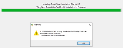

Hello Everyone,
I have a freshly setup Windows Server 2016 Machine. I installed the newest JDK (13.0.2).
When running the installation Wizard, the installation ends with the message:
"A Problem occurred during installation that may cause an unsuccessful installation
foundation installation failed"
followed by the message:
"There has been an error
Thingworx Foundation trial for h2 installation failed. Please check the logs. The application will exit now"
Unfortunately I can not find any log files. I also can not try another installation since "There already is a Thingworx version installed".

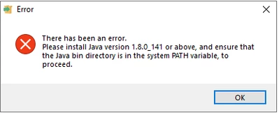

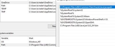

I first installed the java jre 1.8 as you can see here
When trying to start the installation, it asks me to add java to the PATH variable

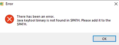

But even after doing so I get this error message:
So I installed the Java JDK Version 13 (Version 8 is not available withouth Oracle Account), which shouldn't be a problem since the guide says Version 8 or above.

This time, when I add the bin folder to the Path variable, the installation finally proceeds, only to fail near the end:
Edit: I just setup an oracle account and downloaded JDK 8 and it works!

Hi @dr1.
Unfortunately, the error regarding the java version indicating 1.8.0_141 or above is misleading.  It's actually referring to the java 8 patch level.  At this time, only java 8 is supported
Glad to hear things are working now.
