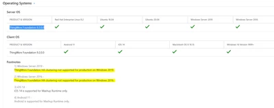

Does ThingWorx Foundation 9.2 installed in windows support HA clustering? I see that in the help document (https://support.ptc.com/help/thingworx/platform/r9/en/index.html#page/ThingWorx/Help/ThingWorxHighAvailability/OverviewOfThingworxHighAvailability.html#wwID0EBQX5B) the architecture diagram has the TW Foundation supoprted but why does the release matrix say that the TW Foundation HA with windows is not supported?

Best answer by slangley
Hi svisveswaraiya,
Please refer to this system requirements matrix for 9.2.  The information you need is in the section under Operating Systems.  ThingWorx supports RHEL 8.2, and Ubuntu 18.04 and 20.04.  There is a footnote advising that Windows is not supported.  Therefore, the operating systems supported for clustering are RHEL 8.2, Ubuntu 18.04, and Ubuntu 20.04.
Clustering is available for ThingWorx 9.1 and 9.2.

Hi @svisveswaraiya_285988.
The information you found is correct--Windows is not supported for clustering.  It's my understanding that our engineering teams are working on it so hopefully it will be supported for future releases of ThingWorx.
