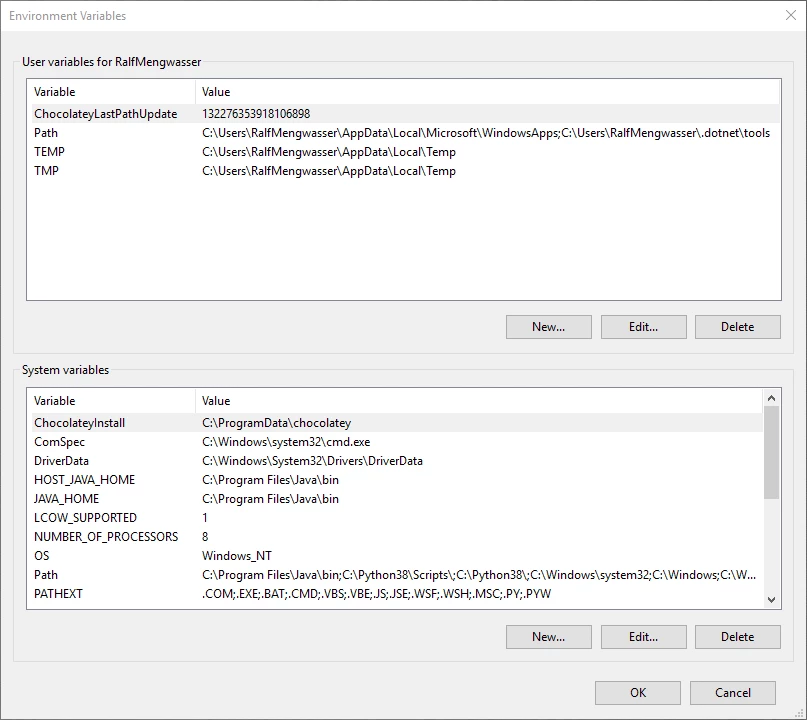

I replaced all the Java versions with the official Oracle Java 8 202 and set up all the env vars.

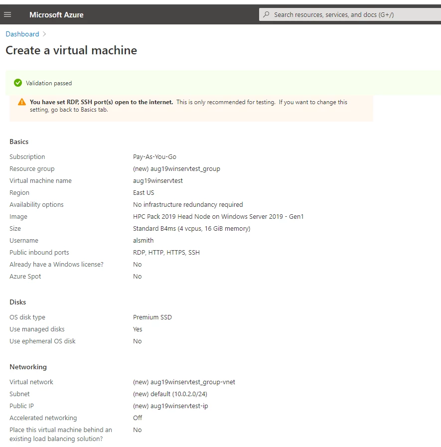

I just confirmed that installing ThingWorx trial works on a Windows Server 2019 Datacenter instance running in Azure:
I created a 4 CPU, 16GB server running the latest available version of Windows Server 2019:
After the server was created in Azure:

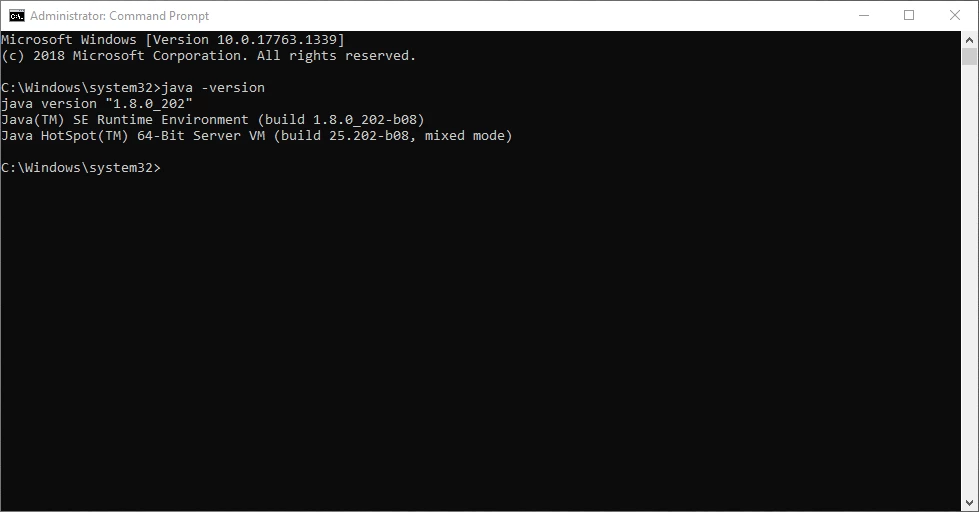

1. I installed 64 bit Java 1.8.0_261 downloaded from Oracle
2. I changed the PATH variable from the default way that Oracle sets it, and added the Java /bin directory to the PATH. You can confirm the PATH is correct by running `keytool` and `java -version` from a command prompt. Confirm that you have 64 bit Java installed.

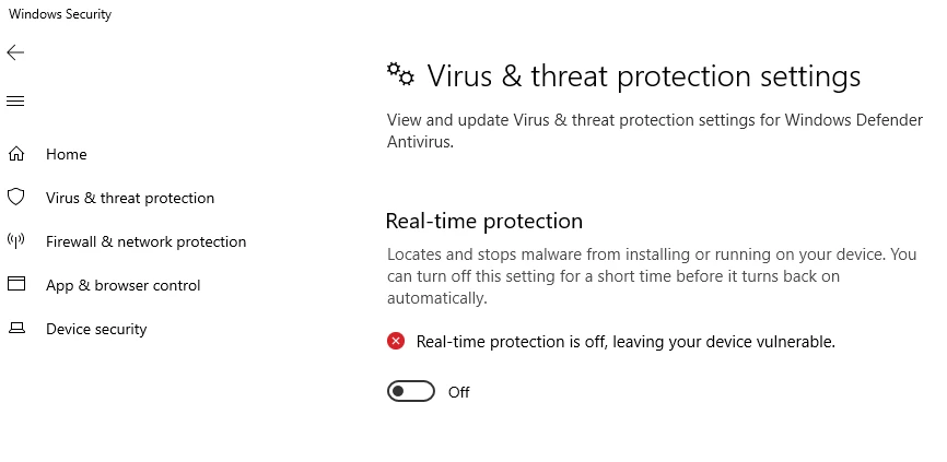

4. I turned off Windows Defender anti-virus software:

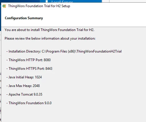

5. I ran the ThingWorx installer as Administrator using these configurations:

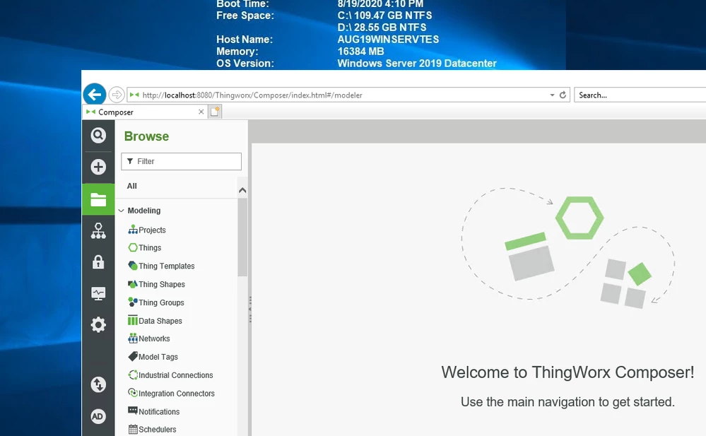

When installation completed, I browsed to `http://localhost:8080/Thingworx` and entered `Administrator` and the password I had entered during the install process.
