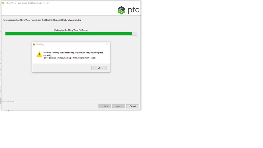

I tried installing my 120 day Trial Thingworx foundation server however the installation terminates and i get an error for "post installation set up cannot be processed. Installation may have failures ."
PFA the log file also that us generated.
I am using jdk 11
The JAVA_HOME path points to my jdk 11.
Also, I have not selected the default ssl option.
Any help would be appreciated

JDK 11 is not yet supported.  Please install JDK 8 to see if this resolves the issue.

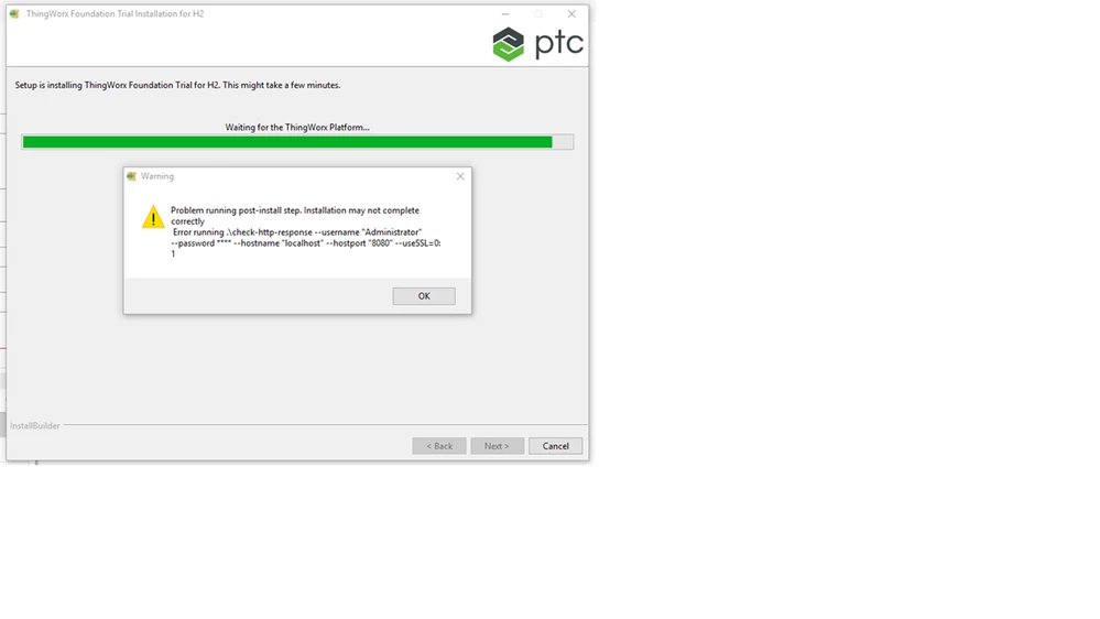

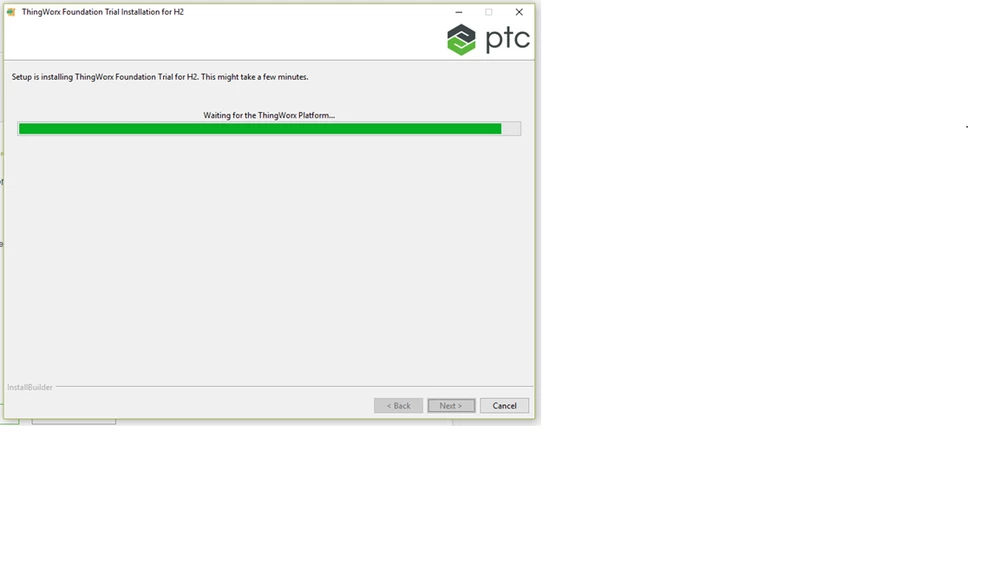

I tried with jdk 8, but no luck
I also tried outside my corporate proxy as i felt the installation terminated while waiting for connection to the IoT platform.
ErrorInPostValidationScripts.pngStuckOnWaitingForTWPlatform.pngTWInstallationIssue.png
PFA my error log and pictures.
Aarushi

- Is this the first attempt at installing a trial version?  If so, was it ever working?  Or did you have a previous version of the trial software installed?  If you had a previous version that has now expired, you will be unable to run another trial without rebuilding your o/s or using a different machine that has not previously been used for a ThingWorx trial.
- Did you validate the system requirements per the installation guide?
- When you run the installer, are you running it as Administrator?  Do you have full rights on the machine?  The log errors indicate a problem with the creation of the service and modification of the path.
