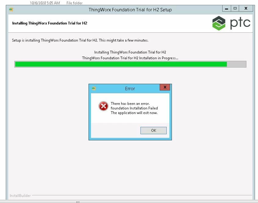

Thingworx foundation Trial H2 installation fails
I am getting following error in foundation-20201014070146.log file.
[2020-10-14T07:03:12-07:00] WARN: Mode 640 includes bits for the owner, but owner is not specified [2020-10-14T07:03:12-07:00] WARN: Mode 640 includes bits for the group, but group is not specified [2020-10-14T07:03:12-07:00] INFO: template[platform-settings] sending run action to execute[change_owner_twx] (delayed) [2020-10-14T07:03:12-07:00] INFO: Processing execute[change_owner_twx] action run (twx_foundation::install line 158) [2020-10-14T07:03:12-07:00] ERROR: Running exception handlers [2020-10-14T07:03:12-07:00] ERROR: Exception handlers complete [2020-10-14T07:03:12-07:00] FATAL: Stacktrace dumped to c:/progra~2/thingw~1/installer/foundation/local-mode-cache/cache/chef-stacktrace.out [2020-10-14T07:03:12-07:00] FATAL: Please provide the contents of the stacktrace.out file if you file a bug report [2020-10-14T07:03:12-07:00] FATAL: Mixlib::ShellOut::ShellCommandFailed: twx_keystore_secret[encrypt_db_password] (twx_foundation::database line 47) had an error: Mixlib::ShellOut::ShellCommandFailed: execute[secret ] (c:/progra~2/thingw~1/installer/foundation/local-mode-cache/cache/cookbooks/twx_keystore/resources/secret.rb line 35) had an error: Mixlib::ShellOut::ShellCommandFailed: Command execution failed. STDOUT/STDERR suppressed for sensitive resource

Hi @CS_9672820.
A couple of things come to mind:
  • Did you validate the requirements per the installation instructions?
  • Did you run the installer as Administrator?
Also, from a review of the logs, it appears you may have tried to install multiple times.  If so, you need to check to make sure any remnants of a previous installation are removed before retrying.  For example, the Chef Client is sometimes not removed.  You can verify by checking in Programs and Features.
