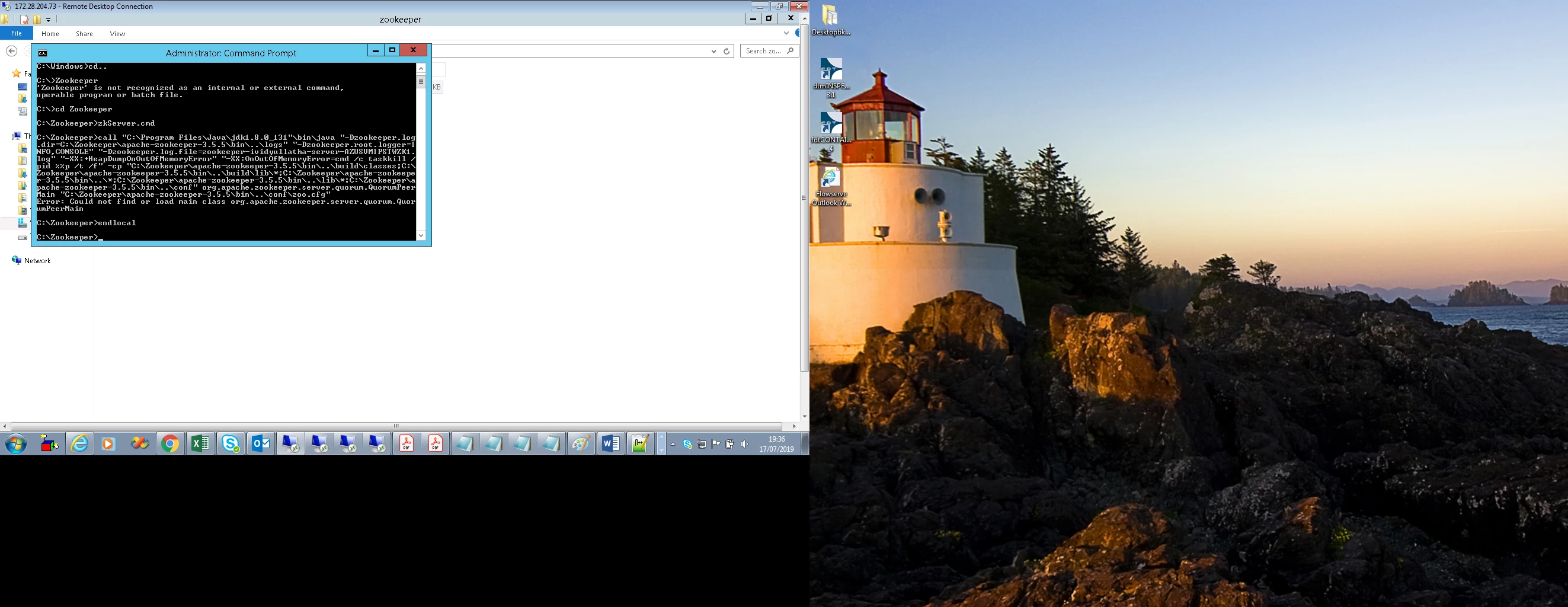

I am configuring HA for Thingworx.
I have installed Zookeeper 3.5.5 and configured Zoo.cfg.Also created myid file.
After that, i am trying to start Zookeeper and unable to start Zookeeper server. I am getting the error. I have attached screenshot what i am getting error.Could you please help on that.

I've just understood -- your myid has ".txt" extension! Remove this extension, it should be called just "myid", then it will work. Keep double slashes though.

Can you confirm that you have a directory "apache-zookeeper-3.5.5" under c:\zookeeper?

Yes, I have created folder "apache-zookeeper-3.5.5" under c:\Zookeeper. please find the attached screenshot.

And I assume you have complete Zookeeper installation inside this folder? Can you take another screenshot of its content, please?
