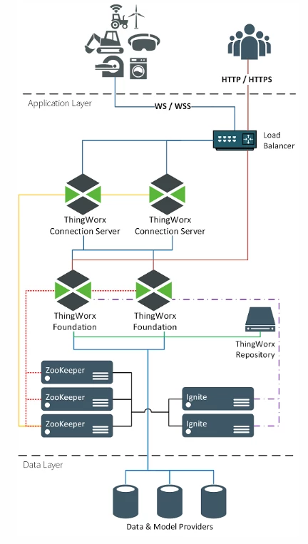

Hi All,
My requirement is for TWX HA architecture. I checked the below link from PTC support.
https://support.ptc.com/help/thingworx/platform/r9/en/index.html#page/ThingWorx/Help/ThingWorxHighAvailability/OverviewOfThingworxHighAvailability.html#
I have a confusion that whether Apache zookeeper and Apache Ignite will be installed on each server node along with Thingworx Foundation application or These two will be present on a separate server from the Thingworx Foundation nodes and maintain the HA architecture.
Thanks for the help.

Although Ignite and Zookeeper are very lightweight, generally they are installed on their own servers, Each servers a specific purpose and works together as a triad or greater, so you don't want them to be affected by the other if possible.

@PaiChung Thanks for your answer.
Just for Clarification so in the you are suggesting is I should have 1 node which will have Zookeeper and Apache Ignite on 1 server, and 2 nodes for keeping TWX Foundation. So that my application would be always running is in HA.
Is my understanding correct, Kindly confirm.

Actually at minimum you would have 2 if not 3 TWX servers. and then 3 or more ignite servers and 3 or more zookeeper servers.
