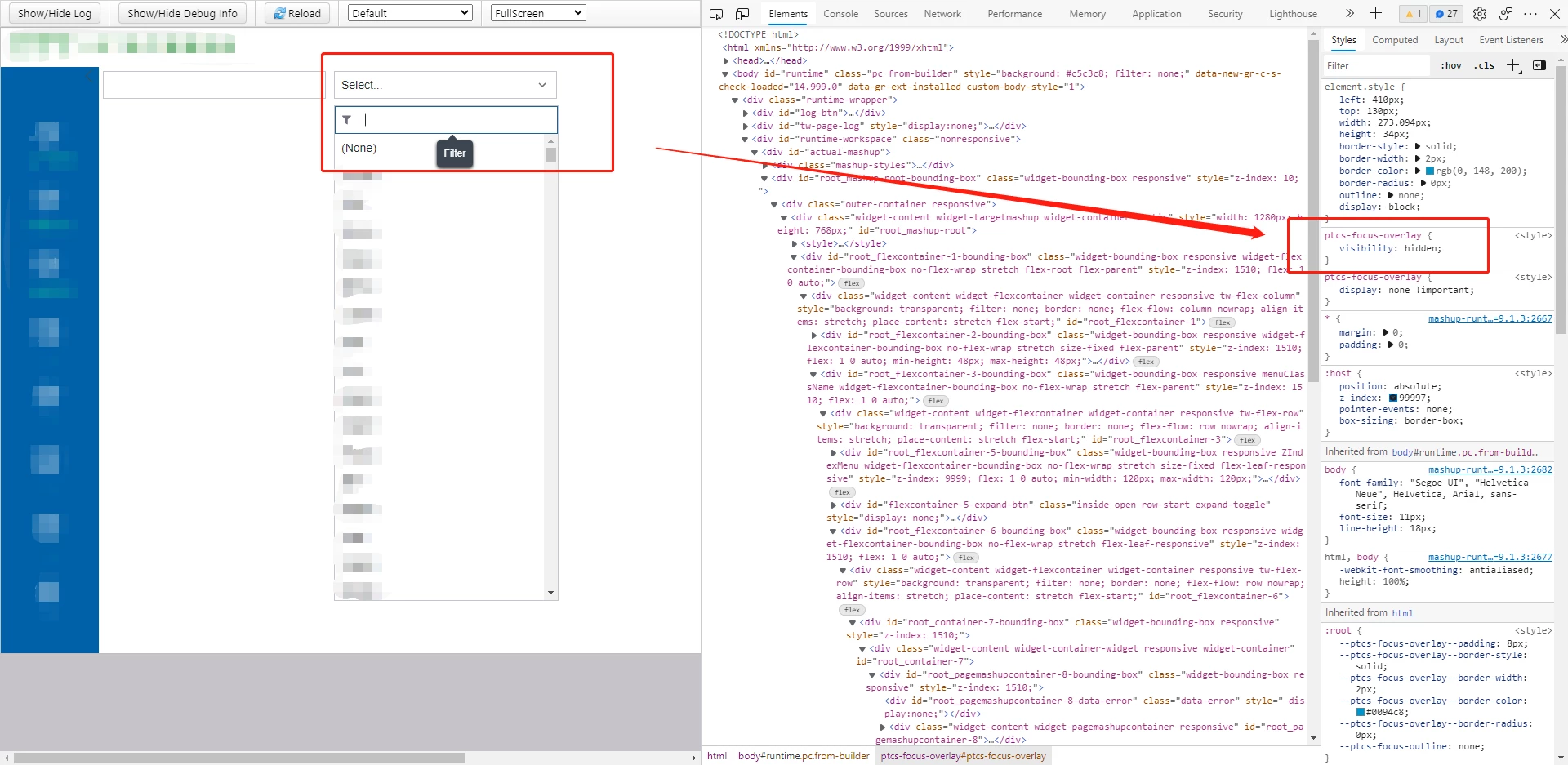

if you enable filter of dropdown widget, while click dropdown widget, filter input will auto focus in opened popup, How can I ban this autofocus action? I don't need autofocus in my scenario.

very thank you VladimirN, it seems not to work for input filter of dropdown widget .

If you add the below under Custom CSS tab of TWX Mashup where Dropdown is added, you should be able to get rid of Default Blue border focus. I verified this on TWX 9.2, what is your version of TWX?
ptcs-focus-overlay {
visibility: hidden;
.ptcs-wrapper:not([no-wc-style]):focus:not(.dummy):not(.dummy):not(.dummy) {
box-shadow: none;
