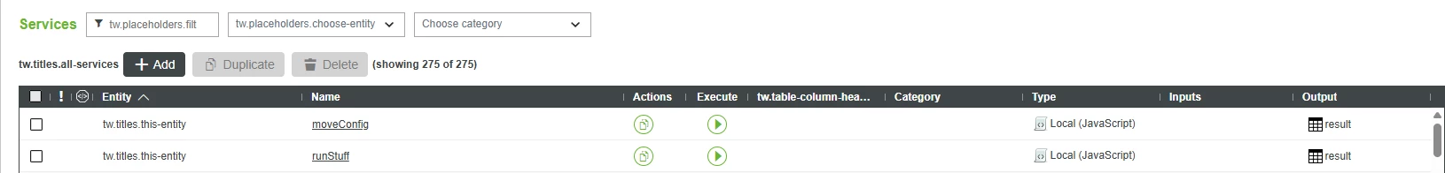

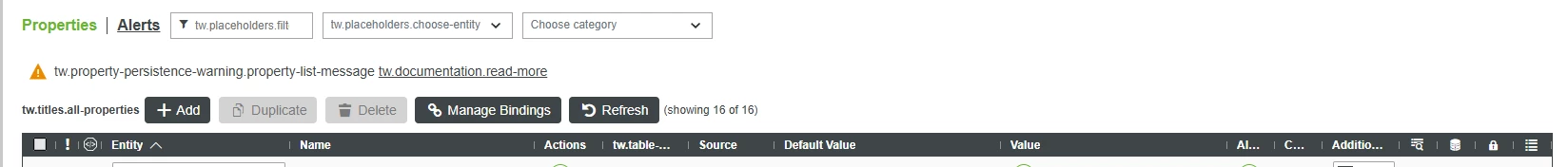

Thingworx in place upgrade 9.3.8 - 9.5.7 missing localization tokens
Performed in place upgrade from thingworx version 9.3.8 to 9.5.7 and several system tokens seem to be missing. Windows server 2019 MSSQL 2019. Example screenshots below. Is there a place to download the system localization tables for english and spanish? None of the custom tokens are missing it appears to be only tokens that are system that did not exist in the version I started from.
7-Bedrock
Jun 3, 2025 2:54 PM UTC
I cleaned browser cache no change. I restarted Apache and cleaned it again and it is resolved. Thank you.
Rocko
Jun 3, 2025 2:16 PM UTC
IIRC the trick was to clean your browser cache.
SM_98027877-BedrockAuthorAnswer
7-Bedrock
