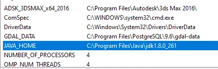

Hello. Can anybody help me with installation of Thingworx trial edition? I`m trying to install it on PC with windows 10. Required java 8 and postgreSQL 9.6 are already installed and defined in Path. The installation stops at the last seconds of process, when system tries to unpack files and get access to the package.

Hello @DD_9594739,
Installation errors with installer usually occur when the JAVA_HOME environment variable is not defined correctly. Please ensure the JAVA_HOME variable is pointing to C:\Program Files\Java\jdk1.8.x_xxx\. From your logs,it seems like you installed a JRE and not a JDK.
Emmanuel
JAVA_HOME variable is pointing exactly to the jdk folder. Screenshot is attached.
Before installing, check that you have installed 64 bit Java, and confirm ‘keytool’ is available on your path. The default Oracle Java installation does not put keytool on your path.

Well, nothing helped.
1. ThingWorx platform is absolutely new to me, I didn't install it earlier/
2. Server port 8443 is free, I checked it.
3. Due to installation process I checked the folder for ThingWorx, the system created it.
4. I tried to switch off the antivirus. It didn't help.
5. I also tried to switch of Firewall.
6. I don't really know how to check this.
7. I didn't use SSL cert due to installation.
