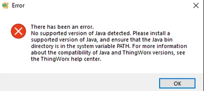

HI,
I have installed java version 8 in my laptop but still not able to install the thingworx.
could someone help me out with this.
I am sharing all the necessary details.
odukiyaAnswer
July 26, 2021
Hello @MK_9986318
The supported Java version for 9.2 is Java 11. Please install Java 11 and you will be able to troubleshoot the issue.

Hello @MK_9986318
Can you please help me with version of ThingWorx you are trying to install?
July 26, 2021
9.2.

Hello @MK_9986318
Please refer following help center guide for your reference.
HelpCenter
