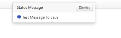

For example, pressing F1 or CTRL+H on a specific mashup would open a 'Help' document for the user if mashup is active/loaded (considering master mashups also). (see  attached img)

document.addEventListener('keydown', function (event) {
 if ((event.ctrlKey) && event.key === 'h') {
 event.preventDefault(); // Prevent default browser behavior
 thisWidget.jqElement.triggerHandler('KeyDownEvent'); // Fire the ThingWorx event
result:
Thank you for guiding in finding the solution 🙂.
