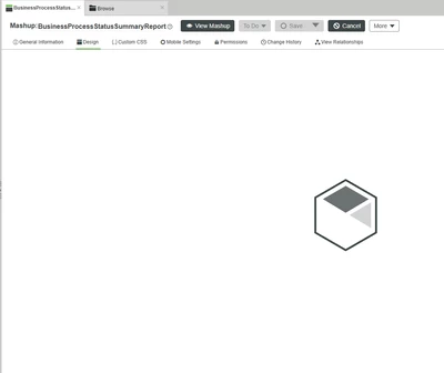

Thingworx Mashup doesn't load in Design Mode
ThingWorx 9.3.6-b1323

Jan 14, 2025 2:39 PM UTC
did the mashup work before? where does it come from?
does it render in "view mashup"?
I would try
- reloading without cache / in a private window. maybe just a browser cache issue.
- check in ApplicationLog if it complains about something

Mashup used to work before. No custom extensions were imported, I can view the mashup without any issues. It's just the EDIT mode I'm having trouble with. I've tried inprivate browser too, same issue.
Jan 22, 2025 5:46 AM UTC
You can try duplicating this mashup and check if you are able to edit new mashup.
Also, is this mashup is imported from other server?, as if the project is built as extension and imported to production it can be non-editable.

Also, please check if any custom extension is imported recently, that also cause issue if there is any issue in custom code.
Jan 22, 2025 8:51 AM UTC
First click General Information tab and then come to Design tab sometime it happens, if its not working then try restarting tomcat, it might help you

I've had it a few times too, with different causes.
The following has helped me every time:
1. Clear browser cache
2. If that doesn't help, maybe check the expiration dates of the stored licenses, under subsystems - licensing subsystem settings - check the expiration date here and update it if necessary
3. if that doesn't help, restart Tomcat
Doing these three things has always helped, at least for me.
