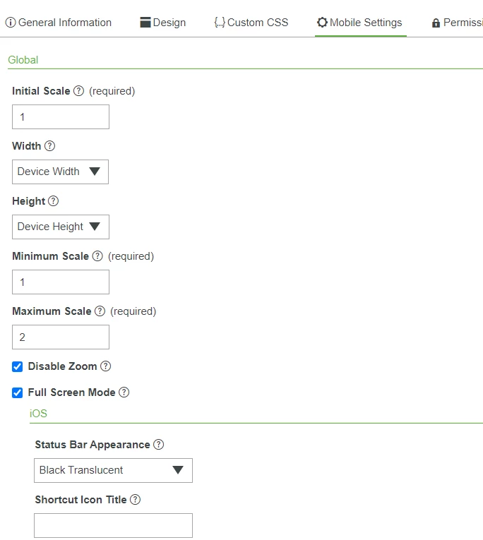

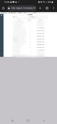

Thingworx Runtime is resizing wrongly my mashup for mobile, it should use device height or resizing on the vertical and font size is small too.
Thingworx version: 9.3.0-b20
Mobile settings:

Hi @slucasTN ,
Can you try using below URL to access your mashup on your mobile instead of the URL of View Mashup from Mashup Builder?
<ThingWorx Server>/Thingworx/Mashups/<Mashup Name>

Thank you, my master mashup Responsive Layout checkbox was off.
