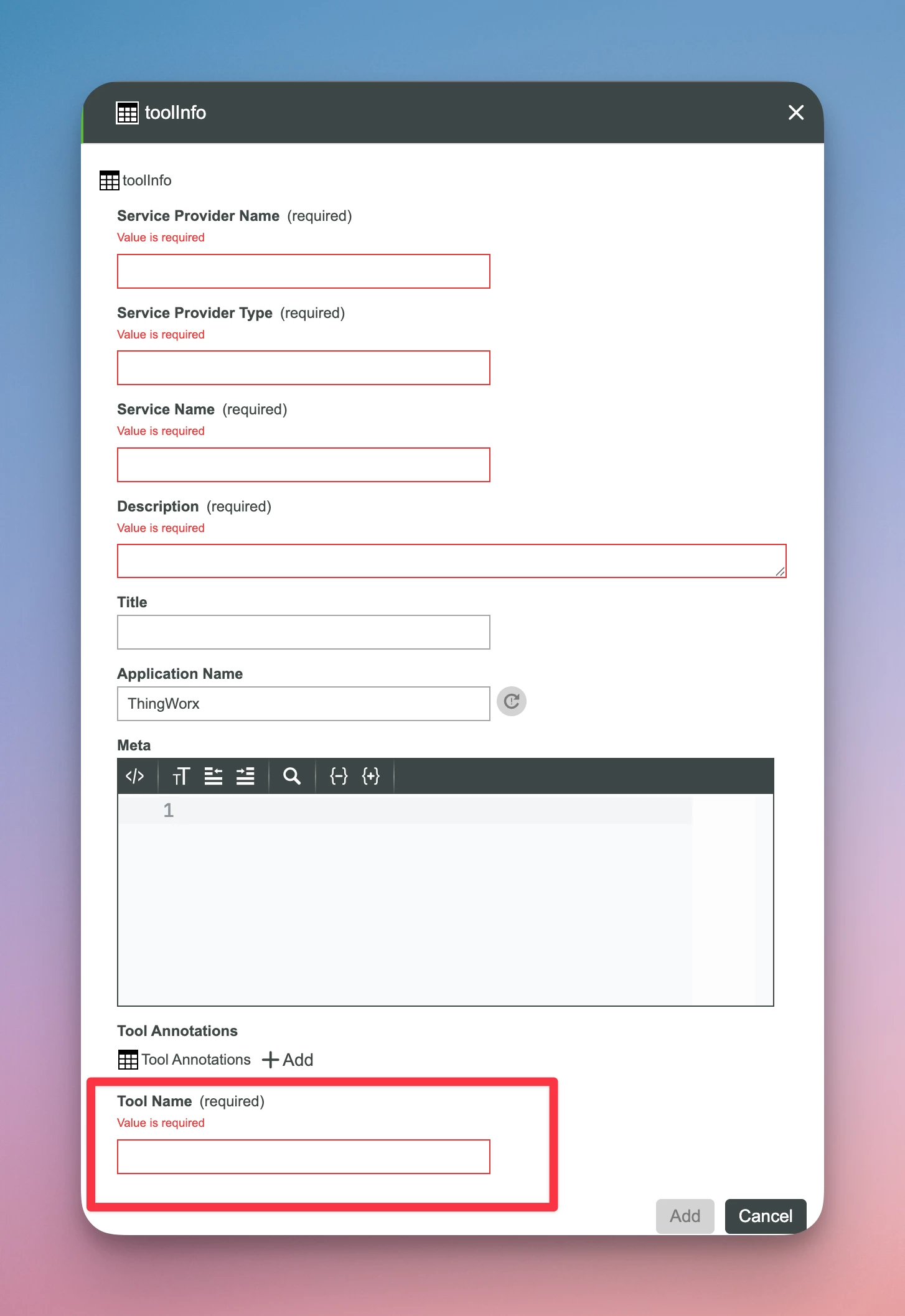

I am not able to register any tools using AddTools in the MCP resource.
It won’t accept the inputs I make
Is there ANY documentation on this or help more than the very limited information in Help pages?
I want to expose a service that takes a string input and gives a JSON response for instance

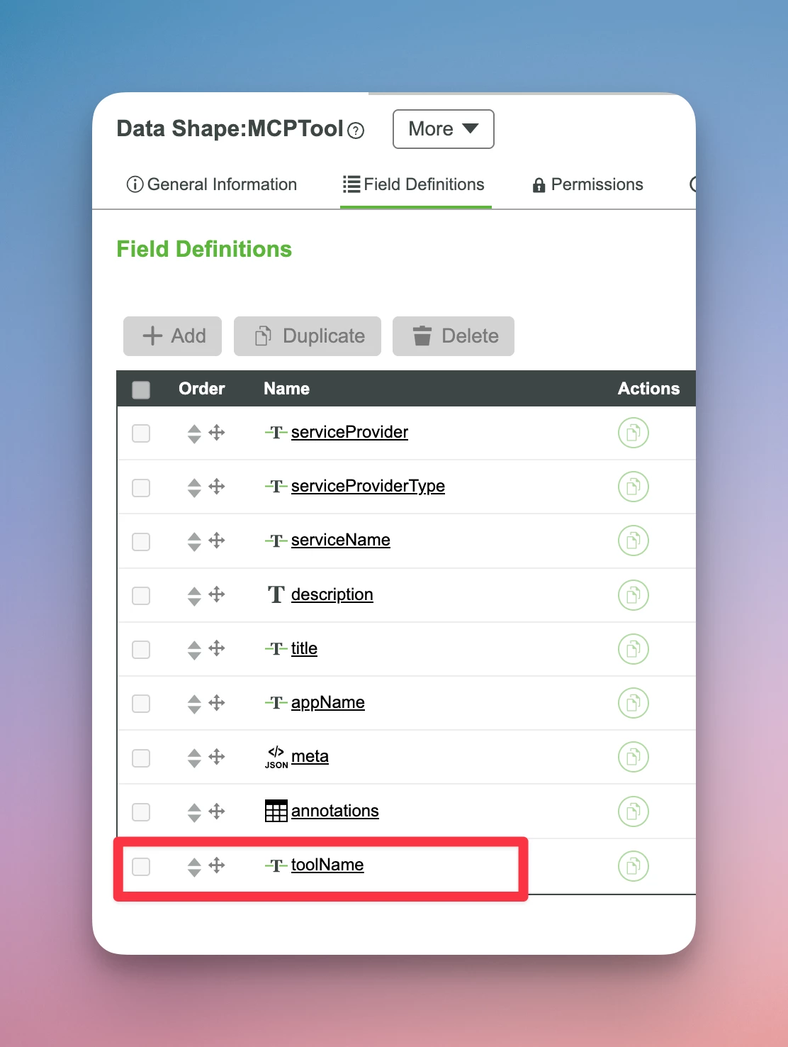

Hi ​@Ascherer17
I can see that you have the same issue. I found the workaround but not the cause.
You are also missing the “Tool Name” in the Datashape “MCPTool”. I have no idea why this is missing but the workaround is to add it as the MCP Server expects it to be there!
Unfortunately this datashape is uneditable by the system and also not importable.
My workaround was to update the datashape in the database itself by adding it to the JSON definition…
Now it works!
MCPTool datashape as it should look

I confirm. TWX 10.1.0 it works and with 10.1.1 fails with specified error. toolName seems to be required on 10.1.1 but not defined in DS.
Workaround adding Tool it via service call:

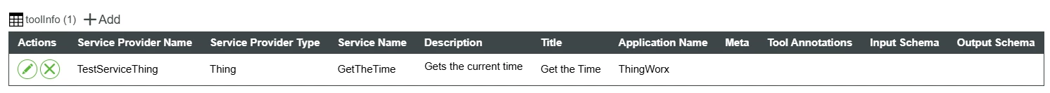

I am having the same problem in Thingworx 10.1.1.  Based on the Examples Help Center doc, I tried using the following inputs into “AddTool”.  The output is blank/No Data and I get an error in the Application Log stating “Tool name cannot be null or empty.”
I’m using VS Code to connect/start the MCP server as the Help Center mentioned.

Jul 28, 2026 7:06 AM UTC
Hi ​@Ascherer17
Now it works!

Great find!  I was able to replicate this and use the AddTool service.  I think you should mark your reply above as the answer.
Hopefully this bug will be fixed when the capability is released in GA.  The part that is confusing is that the service works fine in the demo video below, about 7:30 mark.
