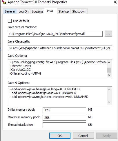

Case 1 : With Jre 64 bit
I have set the Tomcat Config/Java/Java virtual Machine path as "C:\Program Files\Java\jre1.8.0_291\bin\server\jvm.dll"
Tomcat didnt start with this configuration. Throws the following error in tomcat logs
" Found 'C:\Program Files\Java\jdk11.0.11_9\bin\server\jvm.dll' but couldn't load it.
%1 is not a valid Win32 application.
 Invalid JVM DLL handle."

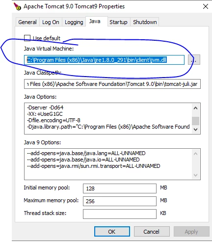

Case 2 : With Jre 86 bit
I have set the Tomcat Config/Java/Java virtual Machine path as"C:\Program Files (x86)\Java\jre1.8.0_291\bin\client\jvm.dll"
Tomcat started for few seconds and stopped. It tried to run Thingworx environment(created thingworx storage file)

You say that you're using x64 Tomcat (tomcat - 9.0.50 64 bit), but according to logs it's installed in x86 folder (  C:\Program Files (x86)\Apache Software Foundation\Tomcat 9.0\)   I'd double-check this first.
Jul 10, 2021 2:36 PM UTC
Thanks for the response. I have checked the tomcat version. It shows 64 bit. Attached is the screenshot for the same.
PN_96718071-VisitorAuthorAnswer
Jul 11, 2021 1:20 AM UTC
The error is resolved. I had installed the wrong JDK( 32 bit). I have reinstalled the jdk(64 bit version) and tomcat again
