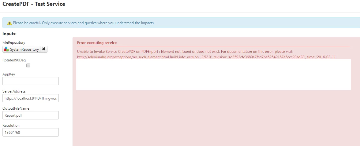

Hi we have downloaded extension some market place and trying to invoke createPDF extension, earlier it was working fine, now its not working throwing an error:
[context: com.thingworx.webservices.context.HttpExecutionContext@2bcbd3fc][message: Unable to Invoke Service CreatePDF on PDFExport : Element not found or does not exist._For documentation on this error, please visit: http://seleniumhq.org/exceptions/no_such_element.html_Build info: version: '2.52.0', revision:
I had that on Ubuntu 13.04 - I discovered some data that the accompanying bundles ought to be included sudo able get introduce libgtk2.0-canister libXtst6 libxslt1 I think the reason for that is that I'm running ThingWorx in virtual holder without GUI. The PDF is currently being created after introducing the previously mentioned packages on Ubuntu.
