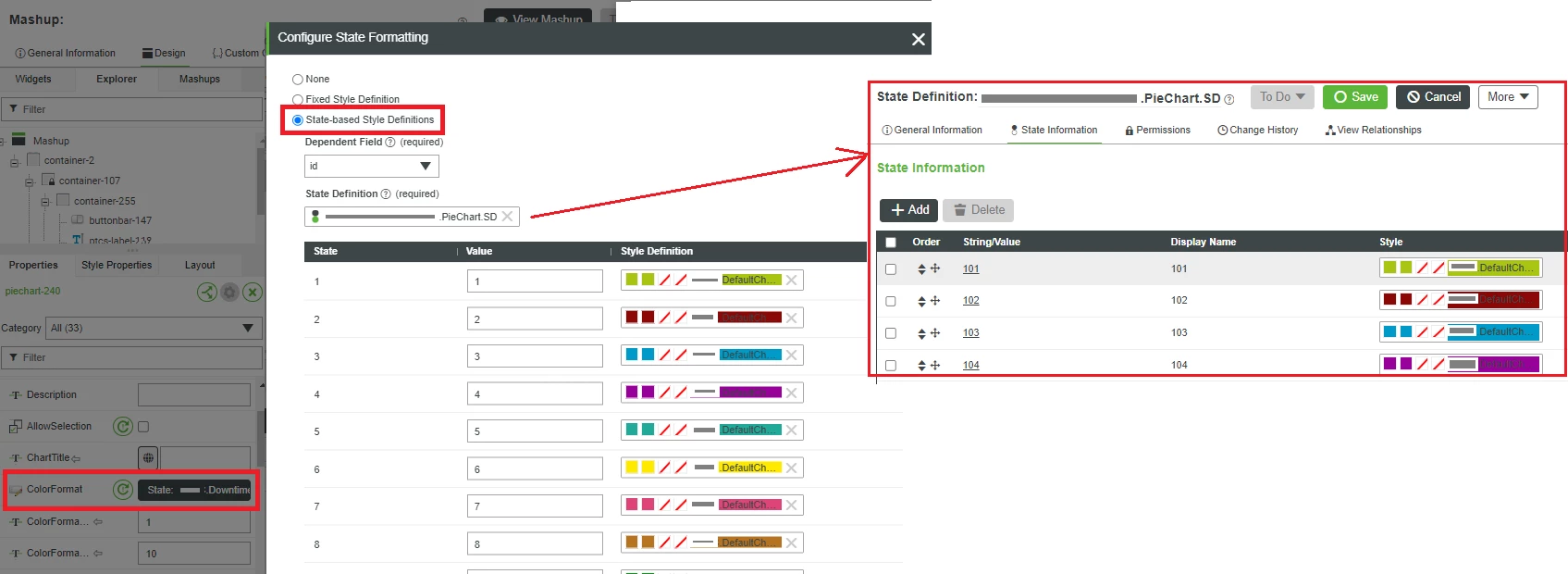

ThingWorx PieChart: How to differentiate TWX Pie Chart color for the dynamic fields
  • July 9, 2022
  • 955 views
Hi community team,
How do we differentiate TWX Pie Chart color for the dynamic fields?
Thingworx Pie Chart is showing the same color for all the fields. I want different colors to be shown among different dynamic data.
ThingWorx Version 9.3.2
@PEHOWE @PaiChung @slangley
July 11, 2022
I recommend you to create a "State Definition" which contains different color schemes (Style Definitions).
Then, in the widget properties, under "ColorFormat", you can set the "State-based Style Definitions" checkbox and refer to your created state definition.
After that a mapping to your values is possible.
I don't know how your dynamic data is structured, however, you may be able to add a percentage value, thus limiting the maximum value. I hope this helps you anyway.
Best regards
Marc
