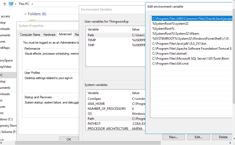

No variable required. Follow below path:
Go to "This PC" right click and got to properties.
In advance System setting click environment variables.
Below Under System variables, find Path variable name and double click it and enter a new row and paste the above path which I mentioned in another reply.
