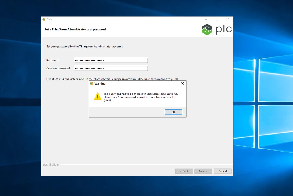

ThingWorx-Platform-Full-Installer-postgres-Windows-8-5-0 (802 MB) throws password strength error
"ThingWorx-Platform-Full-Installer-postgres-Windows-8-5-0 (802 MB)" gives a password error though the password matches the strength and the installation is terminated. This is an installer for Thingworx + Flow.
Kindly suggest a solution or if this is a release error. We have entered a password strength of more than 20 characters.

Hi @DivyaMalika.
The password has to be a set of totally random characters--something like 3Bsk30caq125H8.  Stringing together words will no longer work.

Thank you @slangley. It worked!
