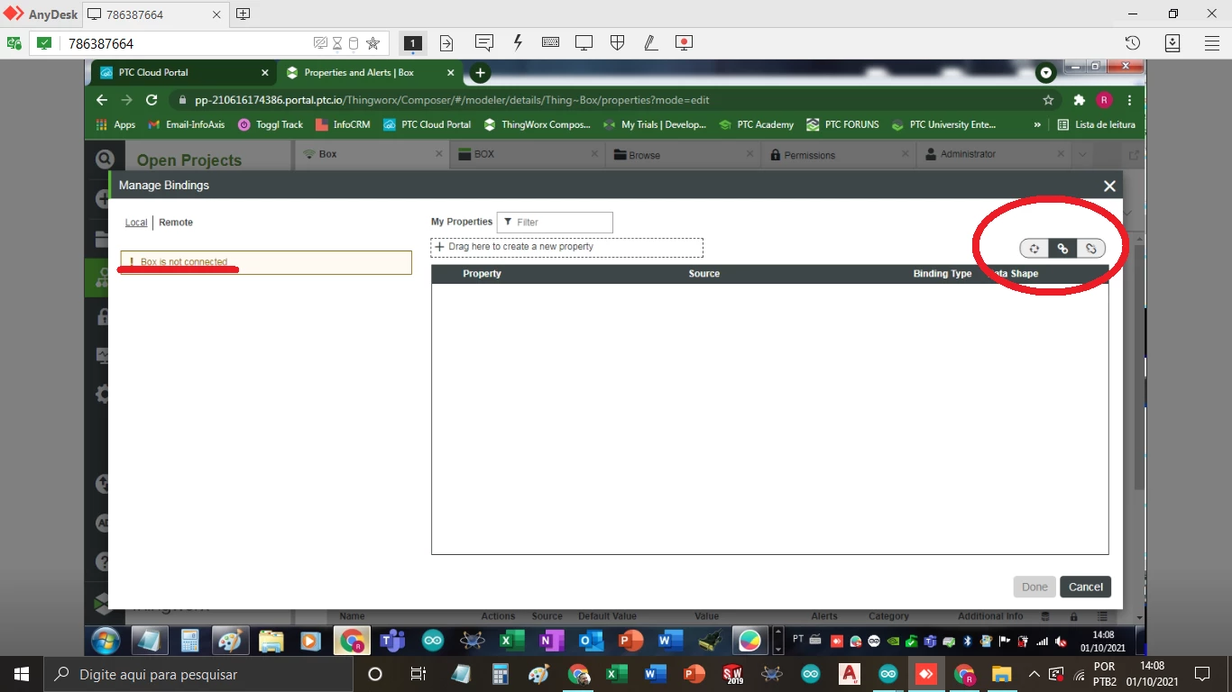

Hi, Team.
I´m use the ESP12F in my board, to communicate with TX.
I´m use the code bellow to update my Things.
String fullRequestURL = String(server) + "/Thingworx/Things/" + ThingName + "/Properties/" + Property1 + "?method=PUT&value=" + d + "&appKey=" + String(APPKEY);
http.begin(fullRequestURL);//Specify request destination
http.addHeader("Accept",ACCEPT_TYPE,false,false);
http.addHeader("Content-Type","application/json",false,false);
int httpCode = http.sendRequest("PUT", d);
The httpCode has answer -1.
In reference table, -1 it´s 404 to web server. But the server keeps on line. Also I copy and paste the generated URL, the Property Thing has updated.
Regards.
Telles.
Best answer by Telles
Unfortunately, I have to chance the microcontroller to ESP32 and solved the problem!
Regards.
Telles.

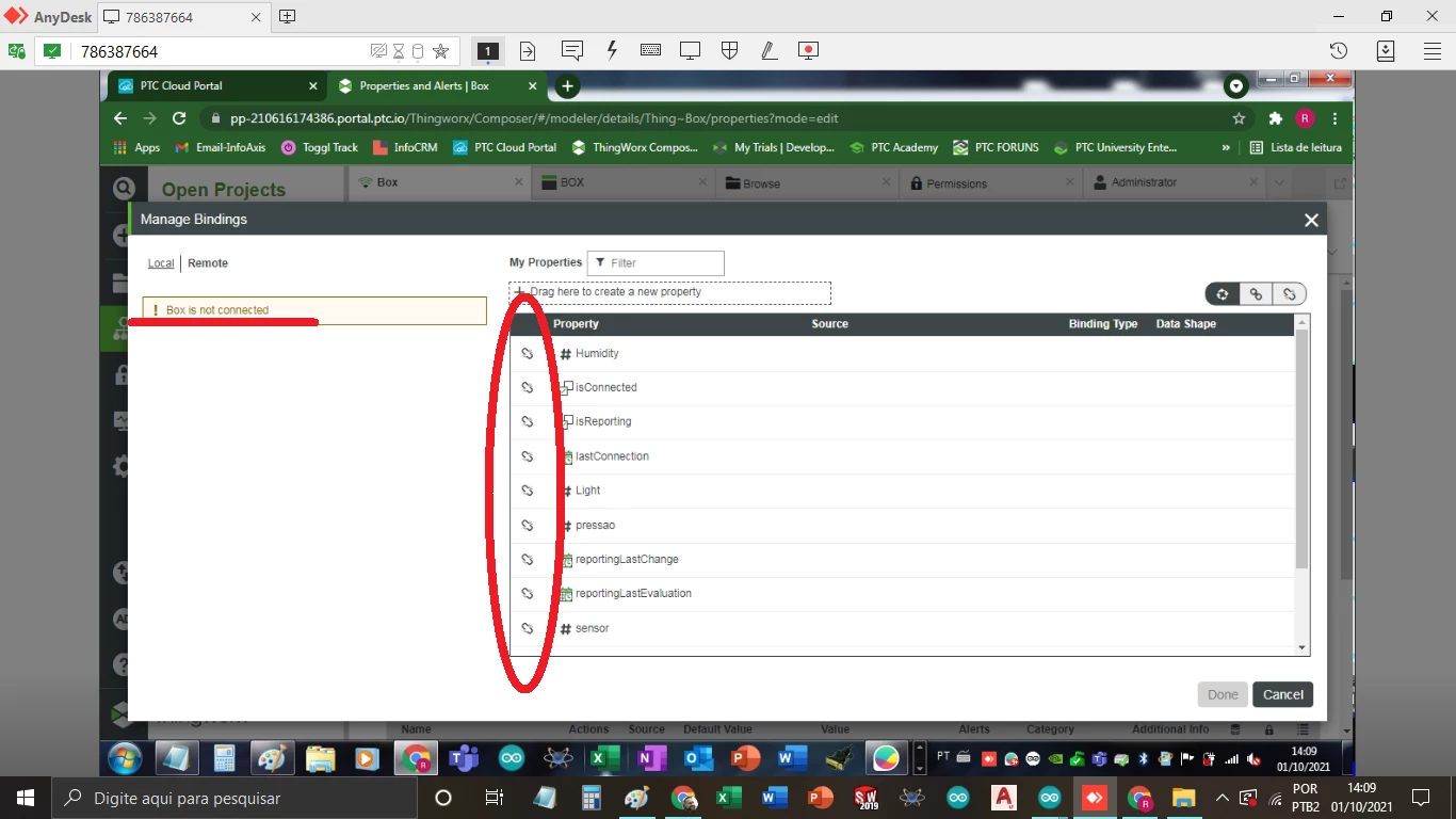

@Telles ,
Did you check the tomcat localhost logs or the ThingWorx Error log?  Sometimes that will yield some useful information about why your request didn't go through correctly.
--Nick

Hi, @nmilleson.
I´m ever check all permissions programs, like TOMCAT, FIREWALLS, etc. At least no lower my security.
I made a different code, abstracting in just one single URL, and swaping the ESP8266 by ESP32, it´s some better. Now the server aswer to ESP: 401. But these test I made by homeofficing.
Regards. Have a nice weekend.
Telles.
