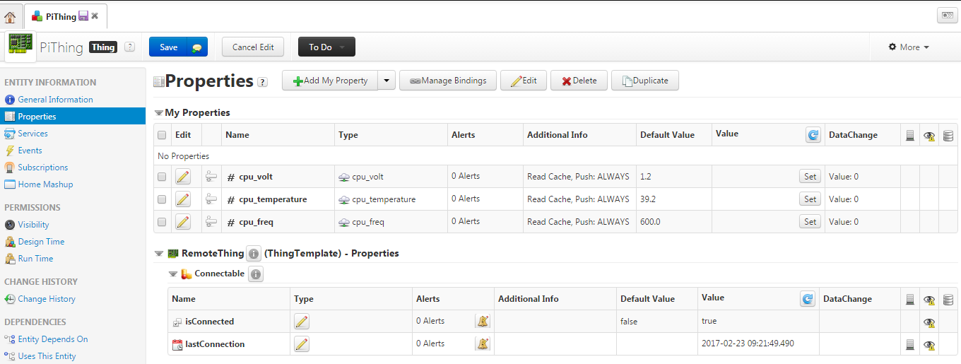

I'm currently working my way into the ThingWorx ecosystem and I am currently stuck on the Raspberry Pi Quickstart Guide when trying to connect the Lua Script Ressource to the running Edge Micro Server.
When running wsems EMS can connect to the platform but appears this problem.
[ERROR] 2017-02-22 03:39:20,806 emsRequestHandler: Thing not bound to EMS, or host is not set
I am in the config.json configuration file of the auto_bind part of the binding name "PiThing","gateway"设置为false
And as long as a run LSR it is displayed
[DEBUG] 2017-02-22 03:39:21, 30 TlsStream::doclose: Disconeccting socket
[DEBUG] 2017-02-22 03:39:21, 30 SDK: twTlsClient_Close: Disconnecting from server
The property can be read on the platform but the property can not be updated

Did you test by changing one of the cache setting for one of the property in ThingWorx, something like below?

Hi Wang, just to confirm is your Thing in the ThingWorx successfully bound? Does it display isConnected = True in it's property? Do you have the identifier defined in the config file to identify the thing attempting to the Thing in the ThingWorx.
Could you also share your config.json and may be also attach the full log here.

Default Value is not 0,Can not refresh
February 23, 2017
Hi Wang, thanks for sharing the log, i can't locate any error in that though. What you have mentioned in your original post is that you see emsRequestHandler: Thing not bound to EMS, or host is not set error reported but the logs which you have shared are clean, unless this is not a complete log.
In fact somewhere at the end of the log that there is confirmation that you have PiThing: Successfully registered PiThing with MicroServer.
Though i did notice at end of the log it said there was update in property but it doesn't reflect here. Could you try changing atleast one of the property's Remote Binding setting to force it to fetch the property update from the edge property using
Before testing please do save the entity and try to refresh if that helps. Otherwise the connection looks good with your above log and the RemoteThing in the Platform.
