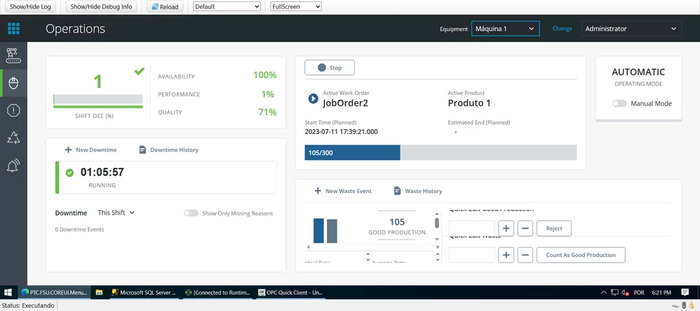

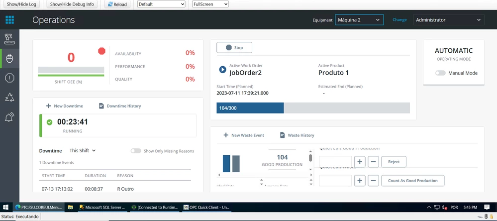

I have six WorkUnits configured in RTPPM, but the only one who calculate the OEE is the Machine1, all the others machines don't calculate and i don't know why because it looks like the rest is normal.

Hi GM
About the error message in your first post, I suspect it's simply not related to this issue.
So the first thing to notice is that all 3 of the KPIs are at 0%. This makes me suspect that the TimesliceSchedule table in the database is missing the records for this equipment, this will also result in the equipment having no record in the Timeslice table. Please refer to this link to see the query to insert the missing records. Because the Timeslices (containing the numbers to get the KPIs) will not be calculated if those records are missing, and the KPIs use the calculated Timeslice values.
Queries to check, if you need help :
SELECT * FROM equipmnt -- find the UID of your equipment
SELECT * FROM timeslice WHERE equipmentuid = ..... -- write the Uid here, I'm guessing this will give no result.
SELECT * FROM timesliceschedule WHERE equipmentuid = ..... -- write the Uid here, I'm guessing this will give no result.

This is the images where the Machine1 is working but Machine2 not.Machine1.pngMachine2.png

Hi mstarnaud!
You were right, my timeslice table was empty, i tried to write the Workunits one at time in the KPI query. I wrote "Machine1" and executed, "Machine2" and executed... instead "Machine1,Machine2,Machine3..." and I don't know why but it worked for me.
